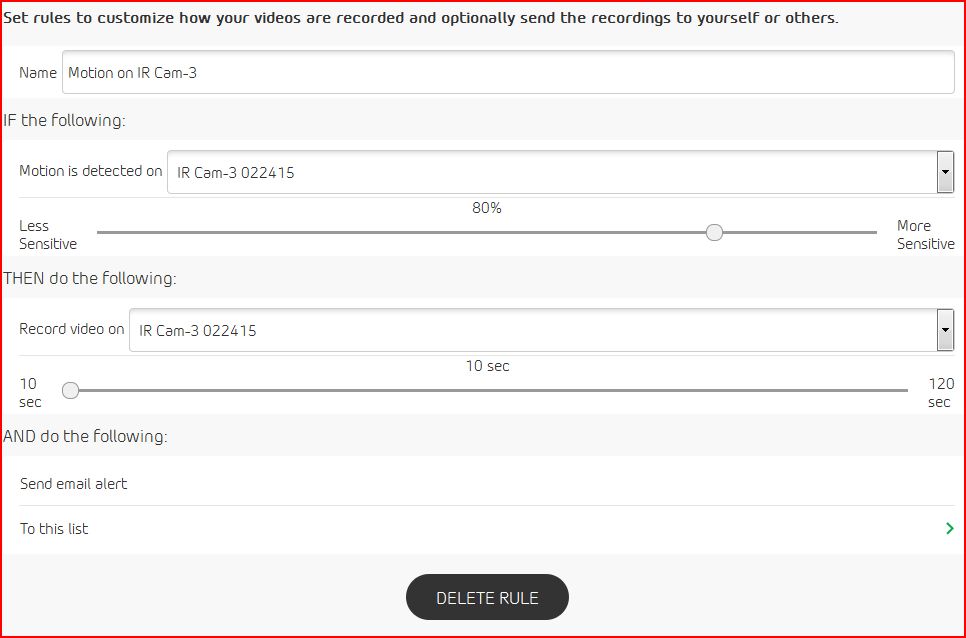

Go into SETTINGS:
So, make sure your RULES are correct for each camera ... like this one ( change name to something like kitchen,etc and time if needed )

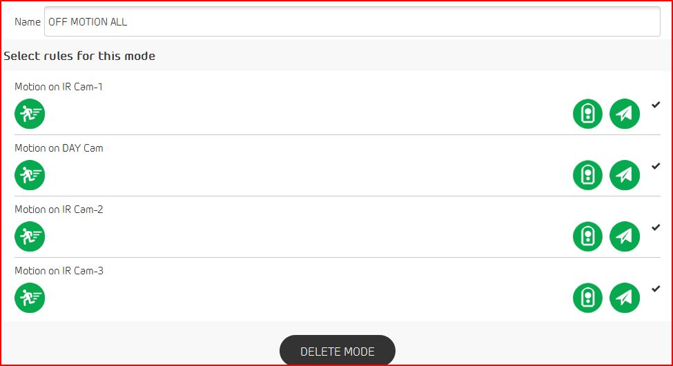

Then go into MODES and add the rules for the cameras... make sure they are all on ( all checked green) / or off ( all checked black) as need be;
( these are all off, so no motion )

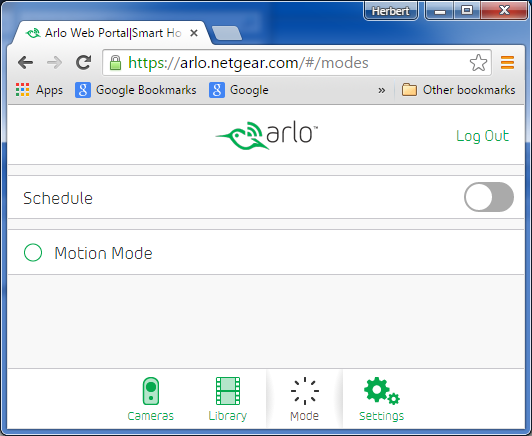

quest2000
Yes I have done all of that, the rules are checked off green when I edit it in the Modes selection.
When I go to the Mode tab it shows the created mode (that I created), however it does not show 'All motion on', or off etc.
The Mode tab just the Schedule which is turned off (all though I've tried both ways) and my only created mode.

Go into SETTINGS:
