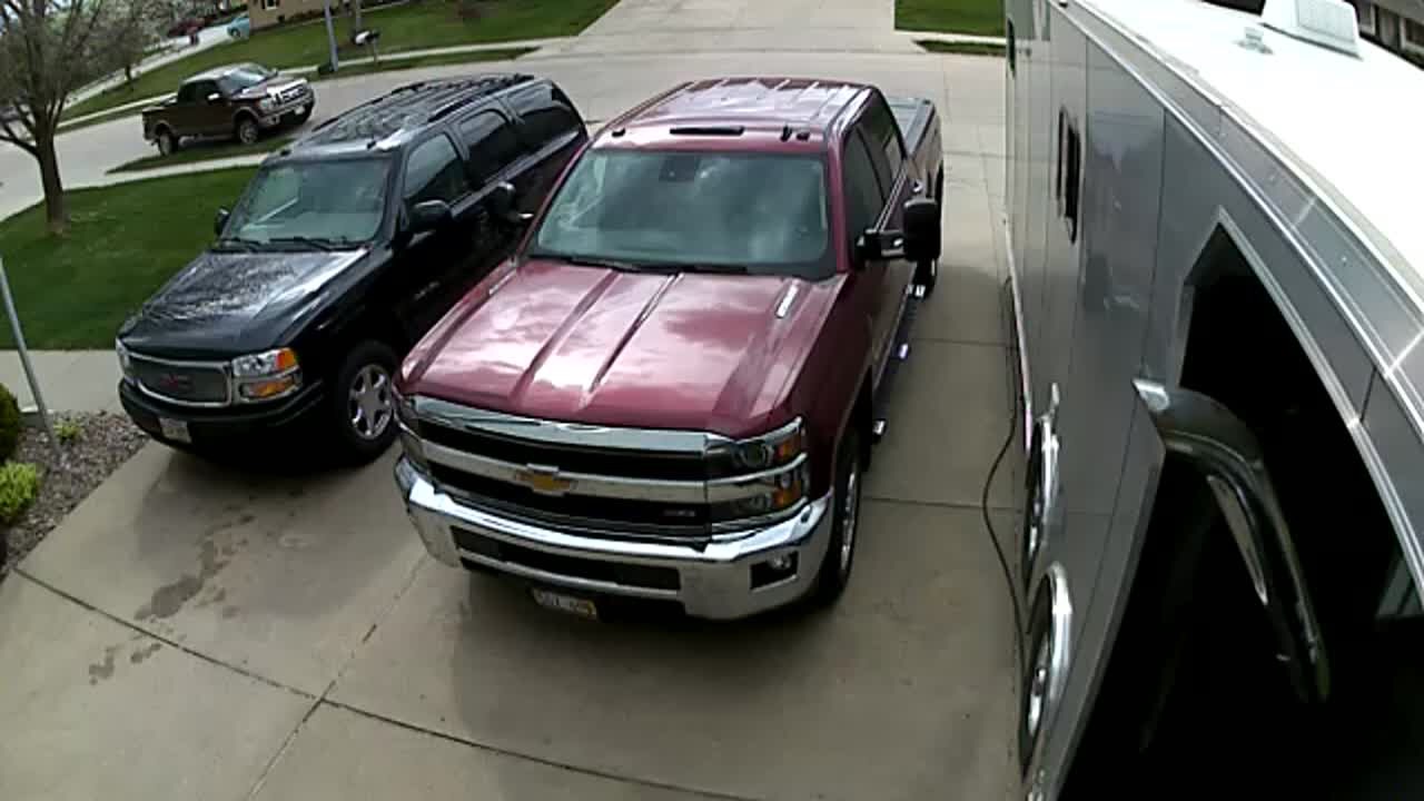

I purchased the 4 camera kit yesterday and have installed 2 of the cameras.  The camera above the rear patio deck seemed to be working fine at first but now it won't detect motion.  The camera above the garage door is not detecting movement unless I'm within a foot or two of the camera.  I have gone through all the troubleshooting threads and believe that I have all the settings and rules set up properly.  The garage camera is about 10' above the drive and I've moved it twice now thinking it was a placement issue.  I've also swapped out this camera with one of the others that I haven't installed yet, still very limited motion detection.  This is a view from the garage camera.  I have walked around both the vehicles and stood in front of the truck with no motion detection made.  Help would be appreciated!  Thanksimage.jpeg

I went in and deleted the rules and created new rules for each camera.  They now are recording and alerting, but the cameras still do not pick up motion until someone is very close to the camera.  If I move around near the front of my truck I can get motion to activate, but not from any further distance.  I have read where other users have to turn down their sensitivity becuase motion is picking up vehicles on the street, I can barely pick them up when they're in my own driveway!   Due to the delay from motion sensing to camera activation I am concerned that I won't have any video should someone approach one of my vehicles or trailer.

Trucky1008,
The issue could be the distance at which you are trying to activate motion detection. Arlo cameras work best detecting motion within 10-15 feet from the camera. It can take some trial and error to find the best placement for your Arlo cameras. To be sure your cameras are placed for best performance take a look at this article: Optimizing motion detection performance on Arlo Wire-Free cameras
