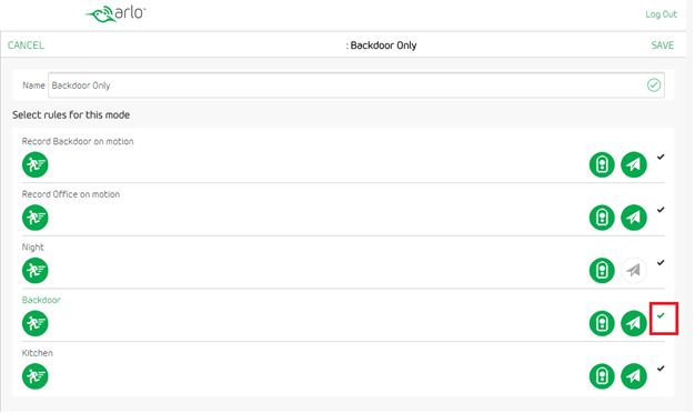

Now we want to go back into our settings page and select Modes then Select Add mode.
First we want to make a mode for just your Backdoor so name that what you want and then click the check mark to the right of the rule you have setup for your backdoor then click save.
Next we want to make another Mode this will be a mode where we have the backdoor active and all other cameras you want active. I only have 2 cameras to use as example but you can add as many as you want this will allow all the camera to be on at the same time and the ones you don’t check will be off then click save.

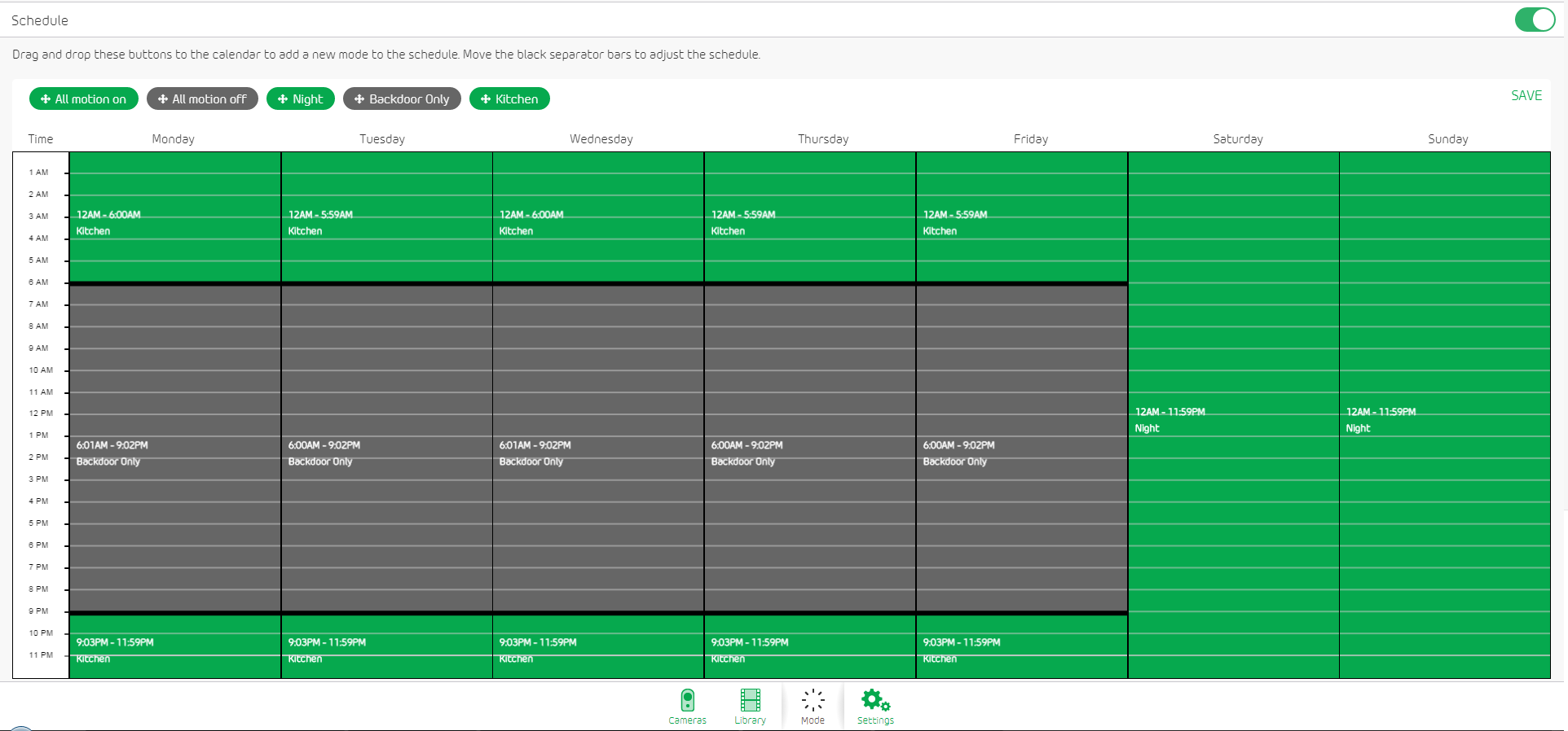

The next thing we need to do is set the schedule for this to work.
Here I dragged into the schedule The backdoor only from 6:01am-9:02pm so from these times only the backdoor motion is active (you can set it to anytime that you want) Now the other section is the Kitchen this is where we set the mode to have the Rule of having the Kitchen camera on and we also added the rule to have the backdoor camera on from 9:02pm-6:01am So now your backdoor camera is always active and you are able to have the kitchen camera on at a certain time.
