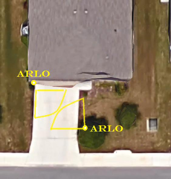

See attached picture....
This might help some of you with cameras installed over garages.  This is the only solution that I have found that works to my satisfaction.  Granted this requires another camera, if you do not have the luxury of installing another camera this will not work.
Installing the Alro camera dead cneter over the garage did not work for me.  It was HIT AND MISS with motion detection because subjects would be walking towardst he camera.  By the time motion was detected, the subject would be at my door or would be caught walking back doen the driveway.
Installing the Arlo Camera on either right or left side also did not work for me.  1. Subjects would still be walking mostly towards the camera. 2. for what I was trying to capture, the distance was too great for the PIR to work effectively.
Guys and Gals in the Community can atest, I WAS FRUSTRATED !!!!!!
The solution:
Hopefully you can see the photo of my house.  I have two cameras, one installed in a tree and one installed n the corner of my house.
-  The TREE CAM is pointed at my garage door and front door. it does 90% of the legwork in detecting motion (L-R).  It is set to 100% and does a fantastic job of detecting subjects walking up the driveway. I have also set up a rule to trigger recording for the second Arlo camera , so it catches the entire driveway and a portion of the street.  the only down fall to having a camera installed in a tree is on windy days, tree sway causes motion triggers so it has to be adjusted to compensate.
-  The Garage Camera in pointed the the Tree CAM.  it covers the other side of the driveway and the street.  It is set to 80%, and I have a DIY hood over the PIR motion detector.  Anything higher than 80%, it would capture cars driving up and down the street (30 feet away).  I also set up a rule to trigger recording on the TREE CAM if motion is detected.
Hit me up if you have questions.....
nturner103
The solution:
