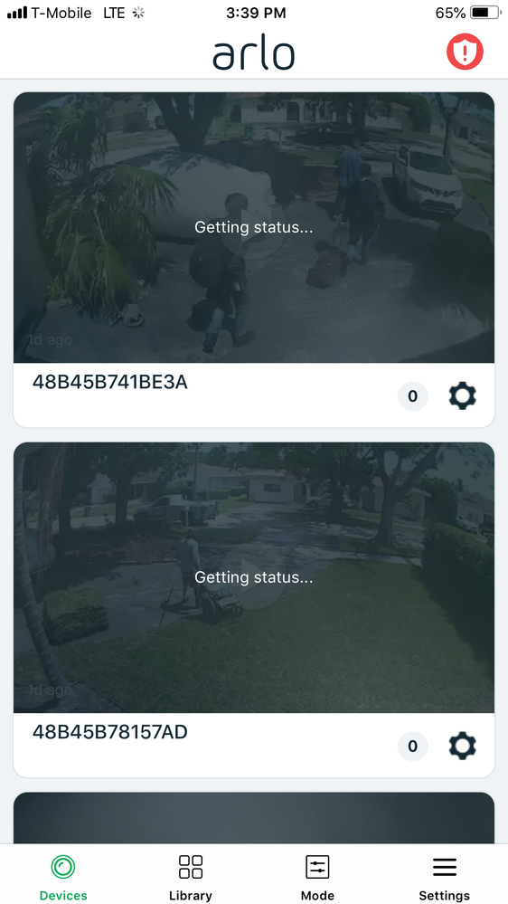

Arlo app will not load live feed of cameras. I can view the library clips just fine, but when I switch to devices so I can see what it is currently looking at it just spins and spins. I have restarted my phone, hit the sync button on the base station, and logged out and into my account. Nothing is working.
Thanks in advance for any help!

I continue to get problem establishing a connection to media server. Have reset router and re-synced but still receive message. This started this morning. Help! None of my cameras work.
I'm having the same exact problem starting today. I'm assuming the issue is on Arlo's end with this many of us suddenly experiencing the issue.

(IPad & iPhone App) No live stream, no alerts, no recordings. Basically, the system has internet, the base station is connected, cameras are connected and library files are accessible/ viewable. Everything has been rebooted, including modem & router, batteries removed, cameras synced and eventually Arlo “reset” returned to default settings. Still having same issue. Next, I went to my PC for live stream and it promptly said “Having issue establishing media server”. So, I am convinced that this entire issue has something to do with Arlo...the cameras will not view, therfore no alerts, no new videos and no live stream.

I've reset the base station and re-added the cameras. Neither live video nor motion detection works. Live video does not work on iPhone and it doesn't work on either Chrome or Firefox browsers from a Mac.
The message I get when trying to view the camera feed(s) from a browser on the Mac is always the same... "There was a problem establishing a connection to the media server."
On the iPhone, there is no error message - simply the spinning activity icon...
