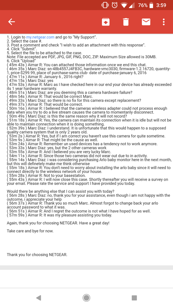

I havent used my cameras in a few months, decided to get them up and running again. i have 3 cameras all vmc 3030 variety. when i changed the batteries all camera updated to firmware 1.2.16720. 2 of 3 the cameras work fine. the 3rd camera wont let me view live i get a "request timed out". It wont record either, but it does detect motion.
I live chatted with customer support and Aimar came to the conclusion that due to a couple months of inactivity, it caused my camera to go bad, even though the other 2 work fine. He even told me I was very lucky the other 2 still work due to not using the cameras for an extended time. The cameras are only 2 years old (to the day), and of course out of warranty.
Just a heads up for everyone, I expected to get more than 2 years out of a quality camera, thats why i bought Arlo. Dont let the cameras go idle for an extended peiord of time, or youll be lucky if they work when you want to use them again!

I tried everything I could think of to reboot the camera. I swapped more new batteries into it, I power cycled the base station and camera multiple times. Removed the camera from my system and resynced it multiple times and still nothing. These are the same procedures support had me do. The support agent even accessed my account and confirmed the camera wouldn't work.
It did accept the firmware update as did the other 2 cams I have, and the other 2 are working fine.
