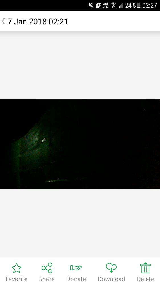

The IR function is disabled. The camera is working fine however. I've inserted two images below which show the issue.
The first shows what the view on this cam looks like through the video settings tab. This is absolutely fine to me. Happy with this.
Video Settings
This one however shows what the images look like through all of the other preview screens, recorded video and when I use ARLO to take a 'snapshot' of the image above.
This is the same kind of issue on all 3 of my cams although I do use night vision on one of them and that works fine. I've tried disconnecting them all, swapping them around, rebooting etc. Nothing has worked.
I also don't seem to have an option to control brightness anywhere.

Brightness is set by using live view and clicking on the sun icon. Adjust the slider and save. You'll need to start live view again to see the new setting.
I've adjusted the brightness (thanks!) and it has helped but the image still isn't as clear or crisp as the image settings preview.
