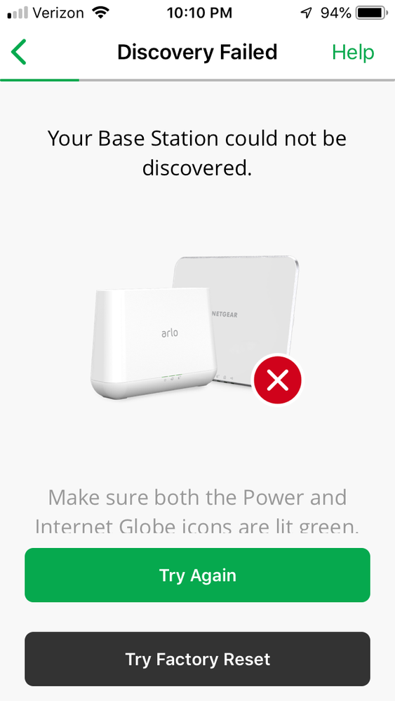

When I try to discover the device, I get a screen that says your base station could not be discovered. Power, internet and camera all show green lights on base station.
Make sure that the device you're using to set it up is on the same wifi network as the base. Ie. Phone cant be using data must be on same network as the base.
Tried on both 5.0 and 2.4. Should I push factory reset on base?
