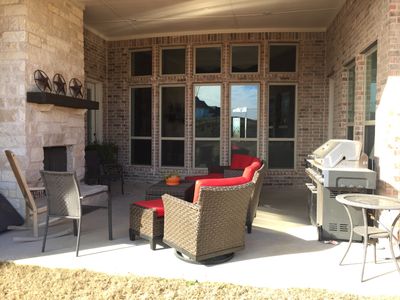

We recently purchased a couple Arlo wire-free cameras and I'm having trouble deciding if where we chose to place them is the best option. I'm attaching two photos here and would love your advice. One camera is for our back patio. One camera is for a side door near our garage (sorry, not sure why it's showing up sideways). Based on the photos, where would you suggest placing the camera for the optimal coverage? I have noticed that where I placed the camera by our garage...it doesn't give the Arlo a lot of time to notice movement. It's kind of narrow up to that black door and currently I have the camera placed above the door. Any suggestions are welcome. Thank you.

The patio has many more possibilities than the garage door. However, you don't indicate where motion would likely come from. You want motion across the FOV which could be detected from any of the walls shown. Tell us more about the scenario.
The garage door has issues - I'd mount it on a side wall, perhaps rotated a bit rather than straight down. The corner by the door may work as long as you resist pointing it out the opening and try to keep just the door and sidewalk in view. Alternatively, mounting it close to the actual entrance opening, getting the door and sidewalk, may be as effective since the motion would trigger the camera and you'd get the subject at least walking away from the door.
In either caase experimentation is needed for best results. Just try to minimize the view - too much scene hurts best detection.
