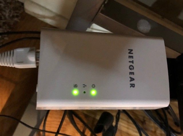

so, what is the white box and cord ...picture ?
Hod913
I will have to take one. It maybe my range extender now that i think of it.

i checked the cord. Using the volt meter and it was reading over 11. here is a pic of the box plugged into my base im pretty sure its range extender.
TomMac
thanks and the middle light is out with IIRC means no communication with your home network
but if so all the lights on the Arlo base unit shouldn't be out.
is there an on/off switch and does it have power pass thru?
I would just unplug the power and ethernet and temp move the base to another outlet and test the base... the power light should go amber and then green if ok
Hod913
I did the move to new outlet already, i have tried to reset the base I can not get any of the lights to come on the base at all. But i move the extender with it each time and it lights up no problem so has to be the base.
