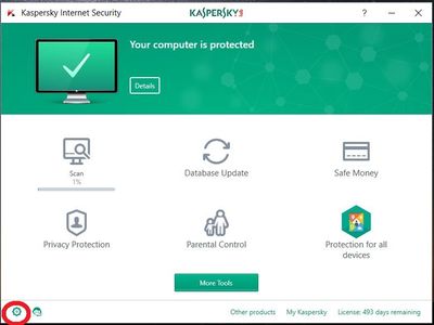

Click the cog wheel bottom left of kaspersky screen.

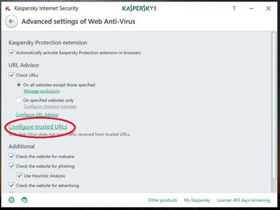

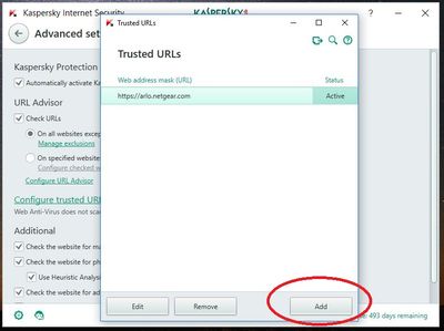

Type in           https://arlo.netgear.com
Click Add.
This worked for me.
Click Add.
This worked for me.

That worked, thanks!
