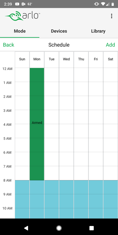

Hi, so I did like you suggested.... I deleted the schedule on the apps and desktop, then added a new one from the desktop log in. I checked my Iphone app and it looks right (even though the minutes are slightly off from the destop to the Iphone app). I check my husbands Andriod app and his schedule is compeletly missing all mornings when it is suppose to be Armed except Monday. I attatched a picture.
I am so frustrated that we arent able to get this schedule figured out. So many issues!
Ok, so next I'd leave your schedule the way it is since you know it's correct and on the android device I'd try clearing the arlo app data and cache.
In android first log out of the arlo app, then > android settings > apps > arlo > storage > clear cache & clear data. Open the android arlo app, sign back in, and hopefully it's correct this time.

If it's correct on the website and on your iPhone, what happens if you log into the android and then manually set it up on there too. Maybe you'll need to make changes on both devices since it's different operating systems using the same account. You shouldn't have to set it on both, but worth a try.

I'm having the exact same issue. This only happens when trying to set a schedule that starts in the PM and ends in the AM.
Because of the way the schedule works, you need to create two timers: the first from the start time in the PM until 12 AM, and the second from 12 AM until the end time in the AM. This schedule cannot be created on Android because it considers 12 AM to ONLY be the start of the day. This means that if you try to setup a schedule from 10 PM to 12 AM the app considers the time to be invalid as the end time is before the start time. This schedule can be created on the website however when attempting to view on Android the schedule will not be displayed correctly and when editing the timer, where 12 AM has been set as the end time, the time will be displayed as 0:00 PM.
We've long been recommening using 11:59PM as the stop time. It used to be forced that way but currently isn't. You don't lose a minute of coverage since it's for the whole minute.
And I also recommend using a browser for modes, rules and schedule since the app sometimes has issues setting/displaying them properly.
