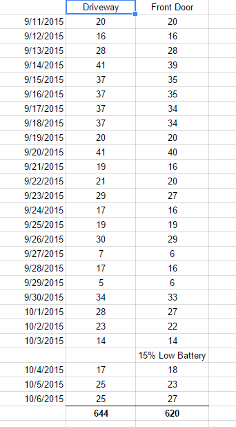

PRELIMINARY COMPARISON OF EAGLETACs and NITECORES
So my EagleTacs finally died on my one camera. The Nitecore is still at 1/2 green bars. I am going to do another test once the Nitecores die putting the Nitecores in the camera that had the EagleTac's and vice versa to see if the results are different depending on the camera. Once I've done 2 tests, I will post my findings in the discussion on Rechargeable Batteries. But here is what I've found so far:
I did this test starting on 9/11/2015 with 2 cameras outside, one facing my Driveway (D) and one facing my Front Door (F).
The Driveway had Nitecores and the Front Door had EagleTacs.
Both cameras were set to "Best Video" and I created rules so that if one camera is activated, the other will start recording. Both were programed to record for 45 seconds. Even tho the rules were set this way, often one (the Driveway) camera would record more than the Front Door camera. I didn't realize this until after day 3. The first three days I assumed that both would be identical and logged in the video counts for only one camera. Once I realized that the Driveway (with Nitecore batteries) was generally capturing more video, I started to log each individually.
I got the low battery (15%) warning on the EagleTacs on 10/4/2015 after about 552 videos (24,840 seconds or 414 minutes). The Nitecores had recorded about 577 videos (25,965 seconds or 432.75 minutes). (I cannot remember if the Nitecores at this time was at 1/2 bar or not.)
On 10/6/2015, I got the notice to replace the EagleTacs at my Front Door. The video count for the EagleTacs at my Front Door from 9/11/2015 to 10/6/2015 was 620 videos (27,900 seconds or 465 minutes). The video count for the Nitecores at my Driveway was 644 videos (28,980 seconds or 483 minutes). The Nitecores are still at 1/2 bar.
Below is a picture of the spreadsheet showing the daily number of 45 seconds video files. Some days there was more activity than others, and for whatever reason, more videos were captured in the Driveway. Even with more videos, the Driveway with the Nitecores are still going strong.
I will update this after the Nitecores finally die and do another test reversing the battery brands. The Nitecores were more expensive than the Eagletacs, but if they last a month, with the high quality video setting, I will be happy with them.
DRIVEWAY= EAGLETACS FRONT DOOR= NITECORES

My Nitecores died 2 days after the EagleTacs. The final run time on both batteries with recap is below.
EAGLETACS: I got the low battery (15%) warning 10/4/2015 (testing started 9/11) after about 552 videos (24,840 seconds or 414 minutes). On 10/6/2015, I got the notice to replace the EagleTacs at my Front Door. The total video count for the EagleTacs at my Front Door from 9/11/2015 to 10/6/2015 was 620 videos (27,900 seconds or 465 minutes).
NITECORES: I got the low battery (15%) warning 10/7/2015 (testing started 9/11) after about 668 videos (30,060 seconds or 501 minutes). On 10/8/2015, I got the notice to replace the Nitecores. The total video count for the Nitecores from 9/11/2015 to 10/8/2015 was 713 videos (32,085 seconds or 534.75 minutes).
Netgear defines Normal usage "as 4 minutes of viewing or recording per day with the wireless camera in the Optimized setting" and they expect batteries to last 4 to 6 months (480 minutes to 720 minutes). Both of my cameras were set at "Best Video" mode and definitely recorded more than 4 minutes a day as I had one camera motion/recording automatically set off the other. Based on Netgear's expectations, I believe both the EAGLETACS and NITECORES performed well. The NITECORES (4 batteries costing $10 more) lasted 69 minutes longer than the EagleTacs.
I am going to repeat this test and place the Nitecores in the Camera that previously had the EagleTacs and vice versa. I will update this when both batteries die in about a month (possibly sooner as the weather is getting colder).
