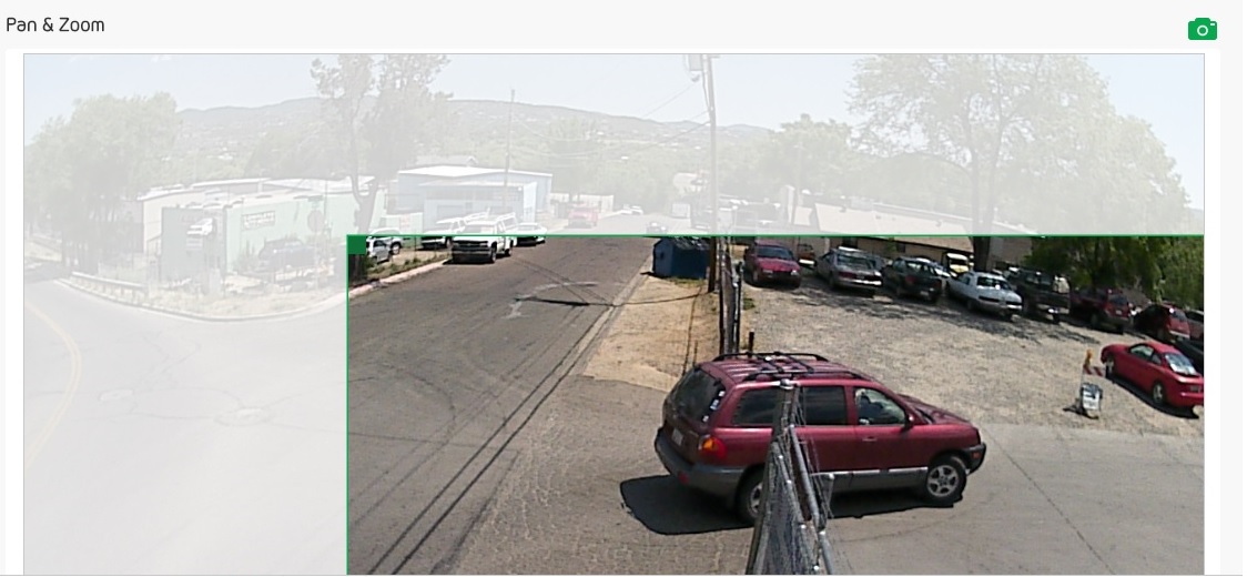

I totally agree, the picture sucks and I can't adjust it to be an better. This is the best we can get. We mounted the camer about 14' high on a pole to try and catch license plates of cars about about the where the purple jeep is. You can't read the writing on the post office truck right below it. Any try at enlarging the image only makes it more out of focus. I'm not exactly sure how close the camer would have to be to catch license plates you can read, but I'm guessing it's close enough to be stolen by the same people we are trying to catch. If anyone know's a way to improve the "HD" quality of this camera besides "Best Video" in the camera settings, please let me know.

Thought I would add my 2 cents... People, please read reviews and look at some actual samples of recorded footage online, so that you know what to expect for resolution and the angle of coverage you are getting. I have dropcams on the inside of my house and Arlos on the outside. Both systems use a wide angle coverage but work for my needs. (In fact I caught a tenant smoking weed on the property, could even make out the little pipe and kit). To expect these cameras to pick up license plates from more than a small distance away is unreasonable. These cams are meant to pick up movement over an area. The resolution with the guy dumping the garbage looks fantastic for a wifi camera but if you want to get a plate be prepared to pay for a completely different camera from a different company. Why buy a wide range camera and then criticize it?
Last point, I mounted a scope to a dropcam in a window and it picked up further detail such as faces just fine at a distance of 300 feet or so. Plates are really hard and they even make a special license plate recognition camera for that purpose. For me, however, I am going to get a hard wired system, maybe with a ptz camera to zoom in on plates, and use the Arlos as a redundant system.
