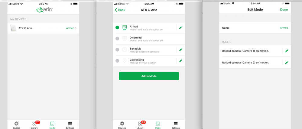

Ok so maybe my peabrain isn't wrapping around this concept or something..... lol
It seems like I need more that the two rule limitation....
I do the following
open app--> select mode--> select my device (there it shows me 4 different modes Armed, disarmed, Schedule, geofencing) I then tap on the green pencil for the "armed" mode.
There are two rules...
one rule for camera 1 (front door)
one rule for camera 2 (drive way)
I select on camera 2 (drive way) as I want it to record when it detects motion.
I also want it to tell camera 1 (front door) to record when it (Camera 2/driveway) detects motion as well.
so if in the rule it says "if the following" driveway "motion is detected" "then do the following"
front door "record video"......
The driveway will not be recording as it is now telling front door to record.
I am wanting the following to happen.
If motion is dected on camera 2 (drivway) all cameras start recording.
If motion is dected on camera 1 (frontdoor) all cameras start recording.
As it is now the motion has to be detected on each different camera to initiate recording...
We are making progress as you have found the page I was referring to. Click on the pencil to the side of the Armed mode. In the Rules section click on the pencil for the first camera, (I will call it Camera A). On the next page under If the Following section click on the down arrow by Camera A's green name. Select the circles to the left of Camera A and Camera B. Now both cameras will record video when Camera A detects motion.
Now go back to the Rules section and select the Rule for Camera B. Repeat the process, being sure to click both circles for Cameras A and B. Now both cameras will record video when Camera B detects motion.

brh wrote:Select the circles to the left of Camera A and Camera B. Now both cameras will record video when Camera A detects motion.
it will only allow for me to select one camera at a time.

For some reason it now is allowing me to create more that two rules per mode.
see the attached screenshot.
I have sucessfully created a mode with the rules that I need.
Now I just need to dress warmly and test.
But according to the rules I made it should work!
Thank you for your help!!!
It is much easier to do the above on a PC... but can be done on an app.
Remember that AFTER you create the new Mode, SAVE it... Then go back and EDIT it to add the additional cameras
