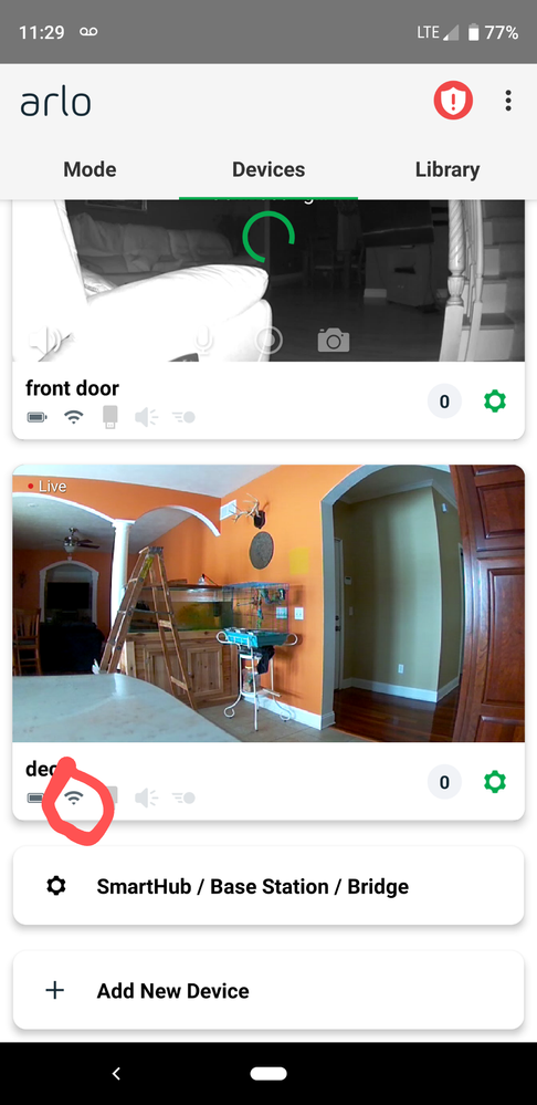

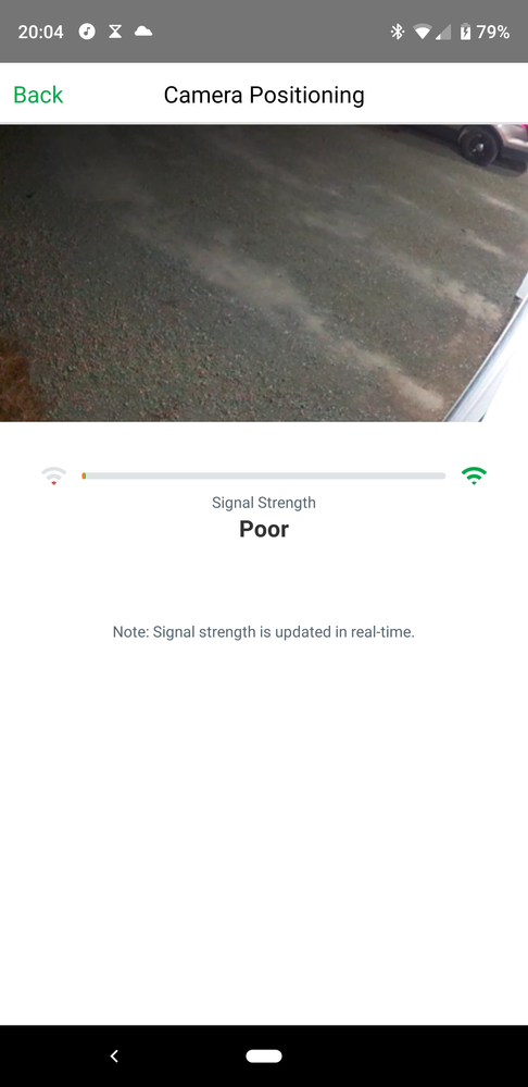

As I've been suggesting here for a while now, use the WiFi indication on the Devices tab for each camera rather than the indication in the Camera Positioning section of  camera settings, which always reads Poor.

And why does the camera reception in device positioning section always read poor?
You have Mode, Devices and Library tabs at the top of the Arlo interface. Devices shows you the cameras and various indicators.
And I have no idea why the Positioning indication always reports poor. I've never bothered to use that for positioning my cameras so don't know when that may have happened.

I attached a couple screenshots. One is what I believe is the section you are referring too, with the signal, I circled it, am I correct?

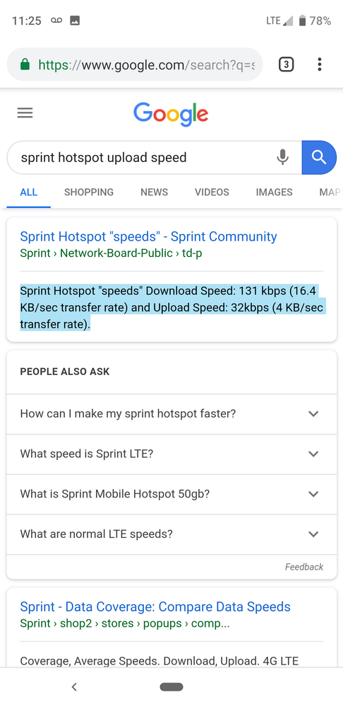

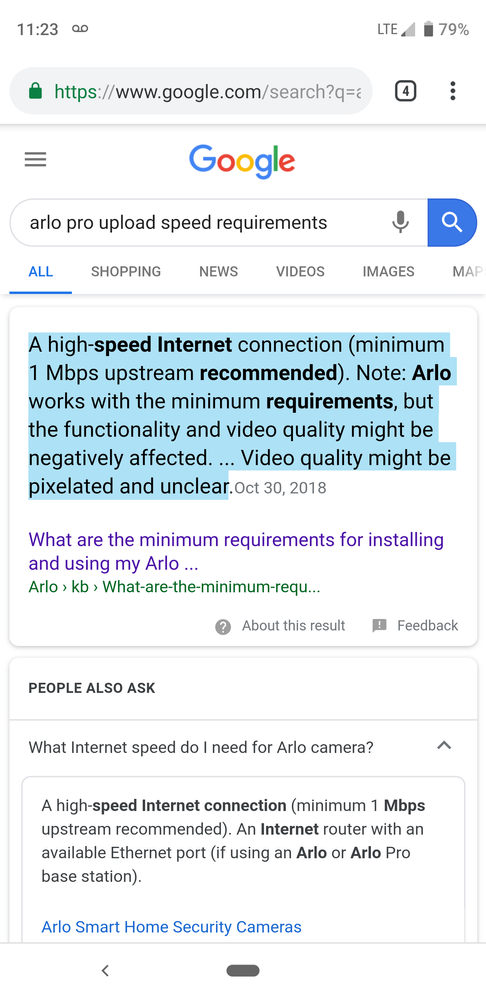

The other is I think it's just my cell service WiFi which does not provide enough data flow. The other screenshots is what I found on the specifications of Sprint and what Arlo needs.

Yes, that's the WiFi indicator I was referring to.
As for the low speeds for the hotspot, I'm amazed it's that slow these days. You can try to maximize the bandwidth utilization but using Optimized or Best Battery Life in the camera settings under Video Settings if you have issues with poor quality and/or truncated videos.

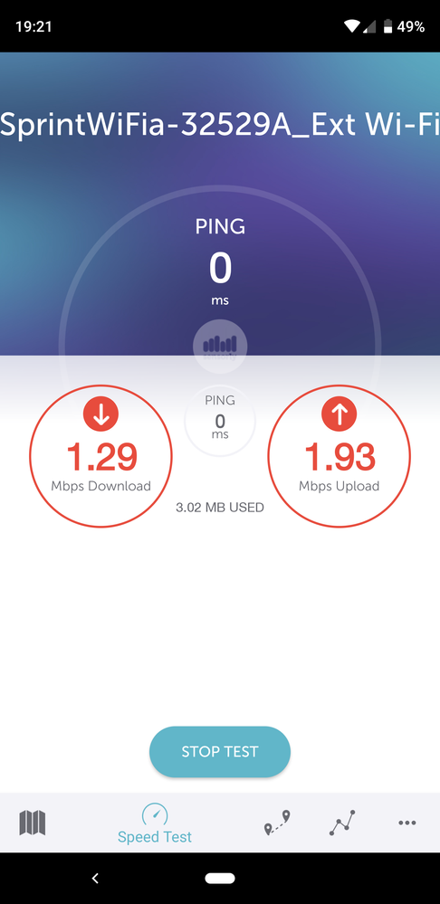

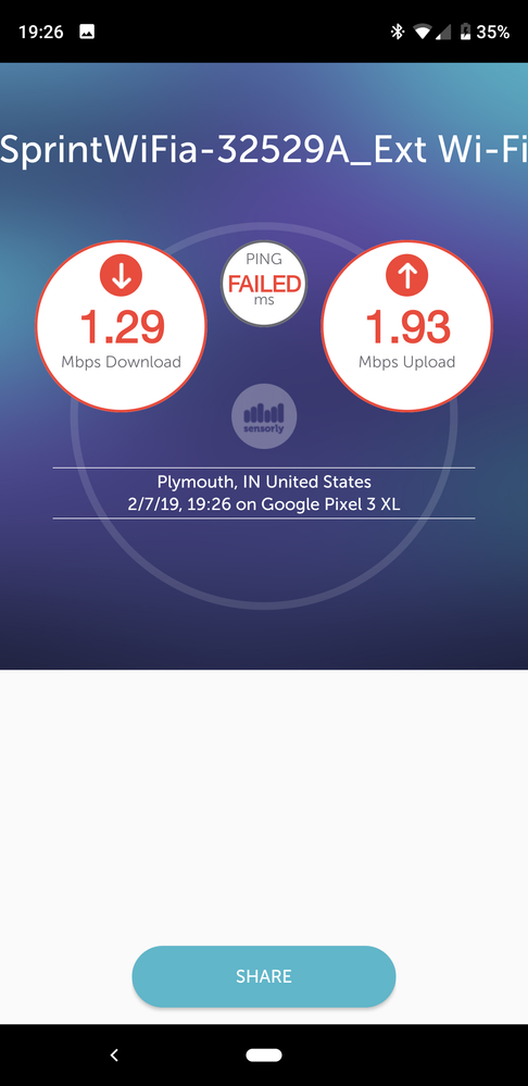

I wanted to do a speed test, and I know this is pathetic but it is still at the minimum requirement of at least 1 Mbps.
I'm honestly lost here, I used the Sensorly app on my phone and connected to the WiFi to do that test. I've attached the screenshot from the test.
Your speed results, while low, should be fine for most situations. The only issue that may occur is if multiple cameras are streaming at once.

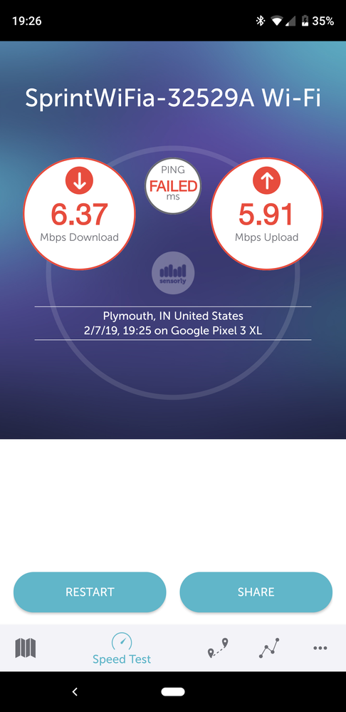

Anywho, so I did a speed test of my new high speed internet, and this I'm really confused on and if there is any internet/data guru that might be able to explain this, PLEASE do! I'll attach screenshots. When I had the Sprint setup like I explained in my previous message, even with the minimum required up data, my video and sound were awful. But now with SLIGHTLY better signal it comes in perfect. However, now, without my network extender, Sprint's signal is coming in stronger.
Rafke77
Sprint mobile hotspot right now
