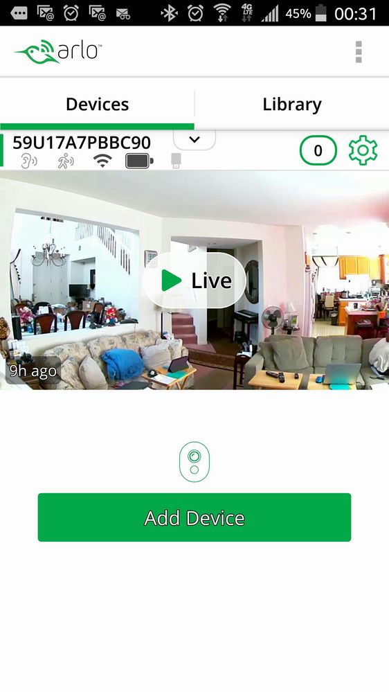

The mode tab won't appear on our Android apps any more. The only tabs visible are now Devices and Library.
The Mode tab worked yesterday for me (Google Pixel 2), and for my wife this morning (Google Nexus 5).
I can log into https://arlo.netgear.com/#/modes and change the modes.
I have restarted my base station, and reinstalled the app. Why would the modes disappear during the day without us changing anything? Is this another server issue at your end? We've had this problem before with an Arlo outage causing hours of confusion, and no notification of downtime.
Same thing. I only realised, that my older app in older tablet works well. So my first help was to find on the web this older version, unistall the new one and install the older one. And it works. That´s not the bes solution, but first help. The version, that works on my S8+, S7edge and on friends Lenovo C2 is 2.4.7_19361-apk.plus.apk.
This is absolutely bolchit. Day two and no fix in sight. I've tried everything. Then we have the bs responses saying it's being looked into. As if they don't have an Android phone amongst them.
Same here. I have the same version app on all my devices and when I woke up, the mode button is gone. There didn't seem to be an update of any kind for the android version. The last update was in April but there has to be a bug with it. Uhhhh, Netgear, how about rolling back a version and let us have functionality back and ease some security concerns...

I grabbed a few previous versions from apkmirror.com
2.4.6.18293 released last October and all is well again. I tried the other March and April releases but they had the same issue. At least I'm functional again and so are my camera modes.

I too, was running the latest release on my phone and tablet for a few weeks, without any issues. Then all of sudden, on both devices, on the same day, the Mode option disappeared. To me, that says the cause is "back-end" and not the application itself. At least not directly. Like yourself, I suspect they changed something server side and did not adequately test it across the different platforms the application is available for.
Until they get their act together, I reverted to the prior release on my phone so I at least have control of the system while mobile. On my tablet, I have the current release still installed so I can still periodically look and see if it is still broken.

Same problem here.... Live view on the cams works fine, but the Mode tab disappeared sometime in the last day or 2..
Tried rebooting base station... no change...
Galaxy S9
Arlo App version 2.4.12_20632 (Updated over a week ago)

I reverted back to an older app from Oct of 2017 and it has the Mode option enabled. Not sure why they chose to take it out for the app. Kinda makes it difficult to manage... oh well, first world problems.

I too ended up reverting to an older model of the Android App (October release version 2.4.6_18293)
Given that the current incident has lasted 3 days with no official communication from Netgear, I needed to get back in control of my installation.
