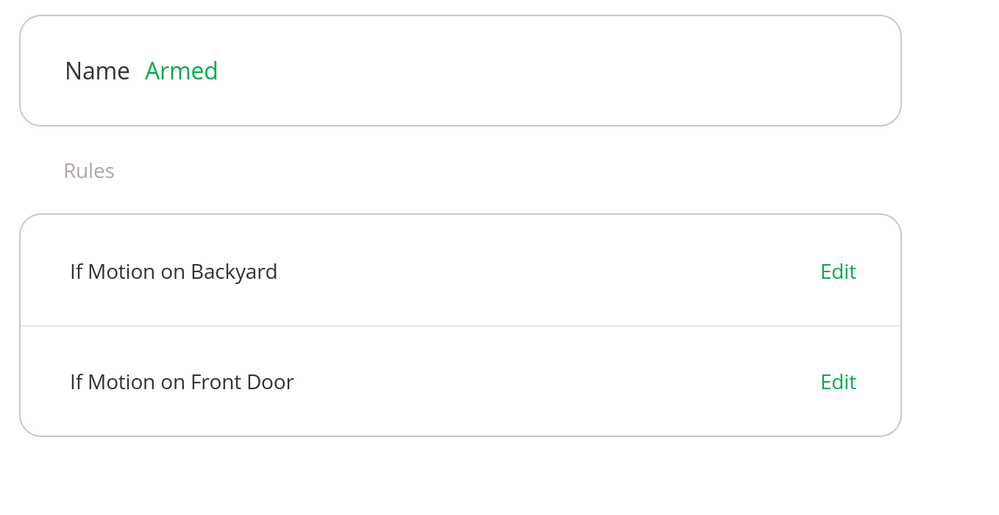

How do you add a RULE to the "Armed" Mode. I have no "Add Rule" button.
I want to add another camera trigger to the list.
A properly installed camera in your system should automatically get a rule in the Armed mode. I would remove the camera from Settings, My Devices and resync it.
There's an FAQ here in the support section on how to create custom modes. Basically, use the Mode tab, select your base and use Add Mode. Note that only one camera gets a rule when creating the mode so save it and re-edit to add more cameras. Any camera without a rule is disarmed.
Copy the ARMED mode in a CUSTOM mode to add additional rules

Armed Mode apparently is the default mode. When I tell my Google Assistant to "Arm Arlo", thats the one that gets enabled.
The camera must be properly installed, as I have a custom Mode using it via a rule (and it alerts, etc).
However, I will try removing the camera and re-adding it. thanks

I performed the following:
- Removed the device from the Android Arlo App
- Rebooted the Arlo Base Station
- Resynced the Device with the Base Station
- Launched Arlo Android app, and searched for new devices (it found)
- Now the device appears in my "Armed" Mode along with the other two devices.
Thanks!
