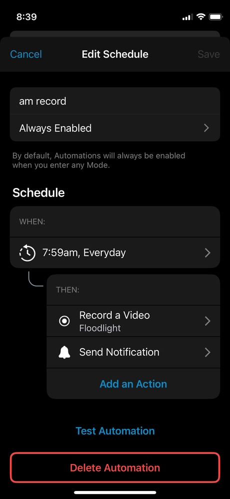

Is there a way to have automated scheduled original Arlo wifi camera to record at specific times?
Example: I want an outdoor original Arlo wifi camera to record a short ten seconds video at midnight or every hour daily. I still want to keep motion detections enabled too.
If you are using the new "Feed" and "Dashboard" interface, then this automation will make a recording:
You'd need 24 of these to get a recording every hour - possible but tedious.
If you see "Library" in your app menu, you'd need to migrate to "Feed". There are disadvantages, so post back for followup before you do that.

@ant wrote:
My old Arlo accounts are still on the old design.
Then your Arlo app won't do what you are asking. I guess you could look into IFTTT, etc.
Though at some point you will be migrated to "Feed", and after that happens you can use the app to do this.
