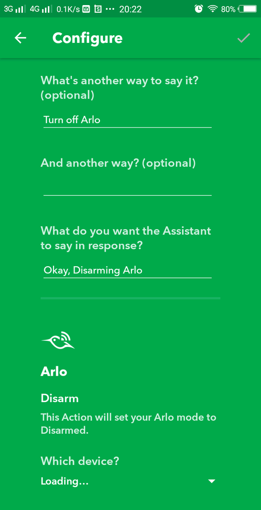

Arlo Action Arm on IFTTT dont work for me either! Message "Loading" then nothing else...........

THEN Disarm Arlo.
and also for Arm Arlo IFTTT
Detail screen shots attached
