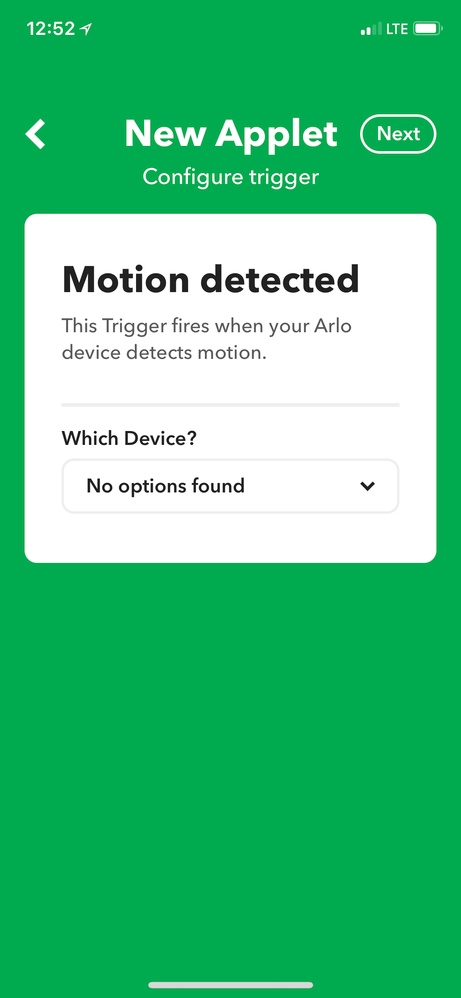

I have the same issue. My account shows as active, but no devices can be found when trying to set up recipes. The recipes used to work and disconnecting my account and reconnecting it has made no difference. Rebooting the camera has also made no difference.

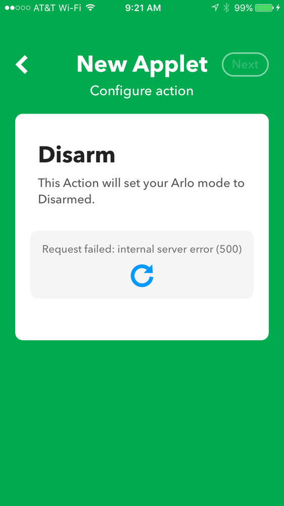

The attached image shows the "Internal server error (500)" on my iPhone that I get whenever it tries to pull the list of devices from Arlo. Arlo engineering needs to get in touch with IFTTT to figure out why it's not connecting properly. Sadly, they are denying there's an issue.

Same issue here. Recipies have worked for months but no longer do. Disconnected from ARLO service and when i try to setup my recipies again it never gets past "loading" while looking for my arlo device.
