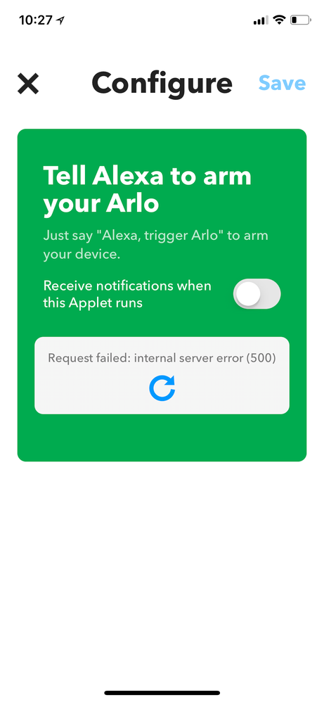

i still am getting an internal service error. who is owning this issue? IFTTT or Arlo?

So I tell IFTTT what to do with Google assistant,(OK Google, Arm Arlo) no problem, but when it comes time to tell arlo to arm, it gets stuck at this screen, asking which device and it's stuck loading, I cannot get any further. I've tried with both the app on my phone and using laptop with chrome and edge browser, and it does the same thing. Is anyone else able to make this applet? It's a pretty simple applet, and I admit I am pretty new to both arlo and IFTTT.

that is the same exact error i get. this is not fixed as netgear has said.

I'm having the same problem with any Arlo Applets. Same screen I'm stuck at. It used to work.
yeah no recipes at all work. i have tried with other services. this is not a recipe issue. this is a netgear issue that was supposedly resolved? shouldnt have believed that.
Whaley12, prodmanager
I've tested this and many other users have confirmed recipes are now working. Try relinking your Arlo account to IFTTT and set up recipes again. Please let me know if you have any success.
