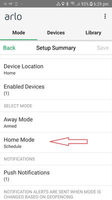

Thank you, very helpful, but it doesn't appear that you can change the rules for geofencing. Am I reading it correctly?
The rules for geofencing are Home Mode and Away Mode.
You can edit the Home Mode so that it uses one of the other modes that you have created. In your case, the rule that controls your door camera.
Arlo Staging
Set the appropriate mode as the Home Mode.
I am doing this with the Arlo App on an Android device. I am not familiar with the iThing app, but I gather that it is less versatile than the Android app.
