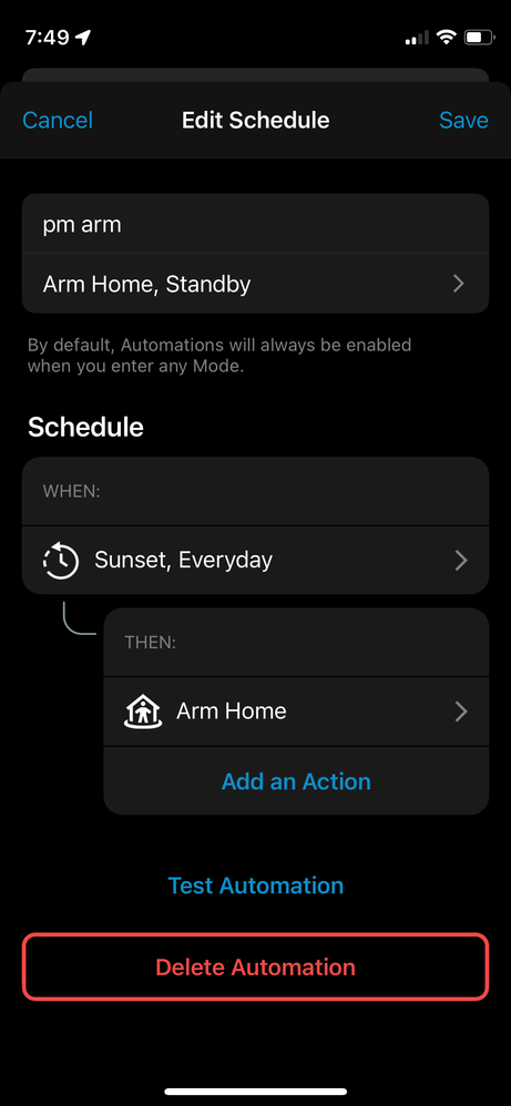

With the original Arlo app it was super simple - Mode: Schedule to set the Cameras to On at 7pm to 11:59p, 12a - 7am the off and done. With this new app nothing seems to work correctly and I'm not understanding the Arm Away, Arm Home and Standby. I've got the Automations set for the schedules (Schedule 1, 2, 3, 4 to account for the 7p - 11:59, 12a - 7a) but I'm not understanding the tree under Edit Schedule -
Schedule 1 (same with 2, 3, 4 accounting for the different start and stop times)
Arm Away, Standby
Schedule
7p Everyday --> Arm Away
What am I doing wrong here. I simply want the cameras to come on at 7p, off at 7am and not be on during the day when we are at home and I keep playing with the settings and they still record movement at all times during the day and night. HELP! It was so easy and simple before...
There is no need to do something special for midnight, because there is no mode change happening at that time.
I suggest deleting all of your schedule automations and starting over.
You need two schedule automations
- one to switch the mode to Arm Home at 7 pm every day
- one to switch the mode to Standby at 7 am every day
These two automations should be enabled in both Arm Home mode and Arm Away mode, but not Arm Away.
Then if you go on a trip, you can manually put the cameras in Arm Away, and the cameras will stay armed until you return (and manually set the mode back to Arm Home or Standby).
You can use these as models (though they switch at sunrise and sunset)

Thank you, will try that. Appreciate the assistance!
