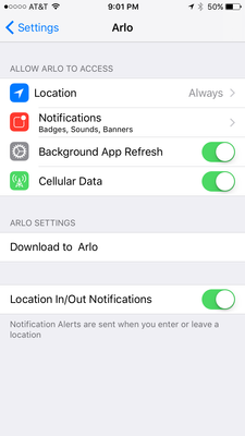

When you say "I have turned it off.", where did you do that?  I've been through the settings at least a dozen times and can't find where that's done.

The setting for Arlo Zone notification is under iPhone Settings.  Scroll down about 8 sections to where all the apps are listed.  Look for Arlo.  Click on Arlo and you will get a screen that says "Allow Arlo to Access". At the bottom below "Arlo Settings" find Location In/Out Notifications.  Flip the switch off (so it is not green).
09KR0058
Ah, that's what I was missing.  Went looking in Settings and none of the apps were there.  That whole bottom section was missing.  I know they used to be there, so I did some searching.  Turns out, ever since iOS 10, there has been an issue with the apps not showing up in Settings.  The workaround is to kill that app (double-click the home key, scroll to the Settings app, then swipe it up to kill it), then go back to the home screen and start it again.  Sure enough, the apps show up again.
When I opened the Arlo settings, all the options were on.  I was away from home when I did all this and when I returned home, I got the two notifications.  First was the one saying I had entered the zone, immediately followed by being back in Home mode.  So, at least for now, its all working again.  I'll have to see if this still works over the next few days.  Since I uninstalled then reinstalled the app, I'd not been back in those Arlo settings, so maybe it just took going in there to get it reactivated.  Only time will tell.
