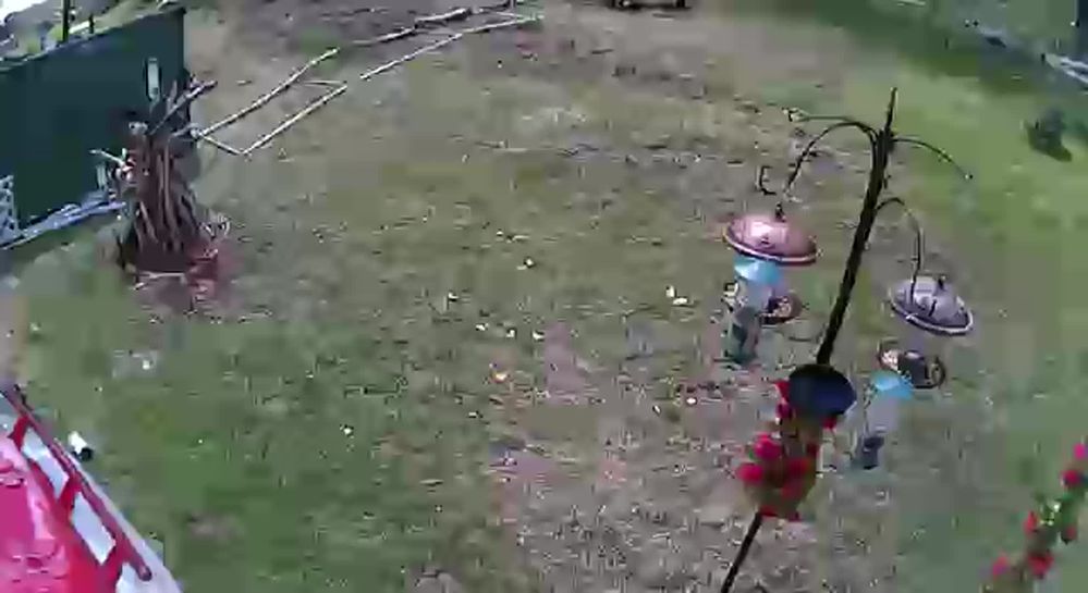

I have 3 base stations, an original VMB3000, a newer VMB4000 and an Ultra SmartHub. Most of my cameras are connected to the Ultra hub but a mix of Pro and Pro 2s are on my 3000. I don't often get videos from these cameras since they're in the backyard, aimed at my deck and koi pond/filter. I've attached one 30 second video since it's one of only a few and has more length than the others. It's from a Pro camera. The 3000 is on 1.12.2.1_2798 and the camera is on 1.092.0.23_32920. I use both Android and W10/Chrome.
https://www.dropbox.com/s/0xj38fmnxp4yrvg/1558885585611.mp4?dl=0
No offense, but this is a pretty crappy video quality and has nothing in common with a 720p resolution. It's more of a 240-360 at the most.

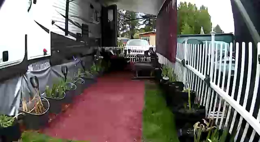

Video is way over compressed, can see the macroblocks.
The little postage stamp video preview is better quality than what gets saved when you record or take a still snapshot.

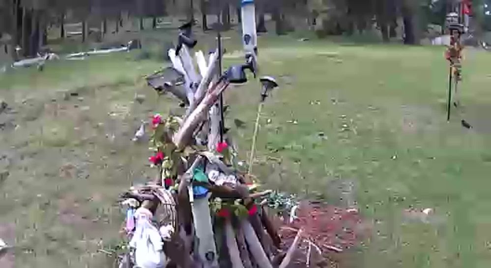

On my phone the videa looks kind of ok when it is in app mode, but if I make it full screen (Pixel 3 with 5.5 inch display) it is obviously pixelated and maybe 4-5 fps. On my 24" desktop monitor it's a joke.
All my cams are set for Best Video. What people seem to struggle with is how the cameras record and store. First, the lens is a fisheye lens with an equivalent of 10-15mm on a full-frame DSLR (depending on the model) - it's very wide angle. Then the original and Pro cameras are 720p - <1 megapixel - which results in quickly pixelating as you attempt to zoom in. Then add on fairly aggressive compression to save disk space and upload bandwidth. You're simply not going to get image quality comparable to even cheap cell phone cameras. These aren't ID-type cameras - they're a monitor-type. If you have doubts, download a high-quality fisheye image from the Internet, resample it to 1280x720 and then save it using a compression level that gives you approximately the same size file as what you get from your cameras taking a snapshot. Zoom in and see what you get.
