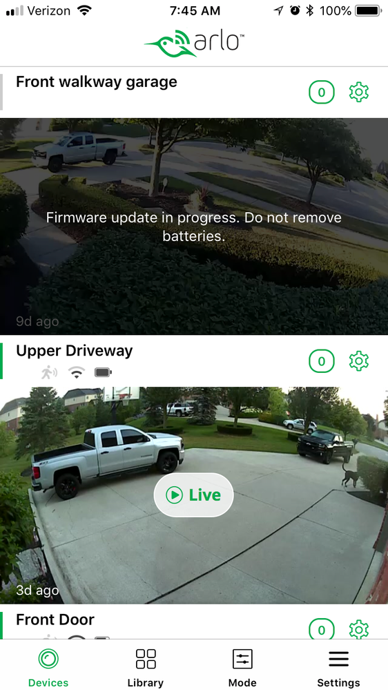

I have exactly the same problem. I purchased a std 4 pack Arlo system from Best Buy and everything was going fine until one of the cameras is frozen due to “firmware update in progress - do not remove batteries”. It has been stuck on this screen for just over a week. So disappointing. This is the second camera that has malfunctioned since buying the kit from B.B. Direct. I’ve tried turning the camera on and off - nothing. Batteries are 50-60% and camera is located within 10 feet of the base station with full signal. Others cameras and system features are all fine. Previously I had a camera die and require replacement with red night vision filter locked on. I hope Arlo / Netgear can help fix his issue because I am done dumping money and batteries into the system as well as doing all the turn on/off reconnect, reboot, try again while going up and down ladders. Great concept but software/firmware is so buggy and being locked into lame range of base station is primitive. I should be able to use my whole
Home Netgear Orbi system 8,800 sq ft as the WiFi hub. - Arlo base station is weak link in chain combined with massive user maintenemace.- beginning to lose faith in wireless camera concept. Here is a screenshot of what I have been seeing for a week or so.

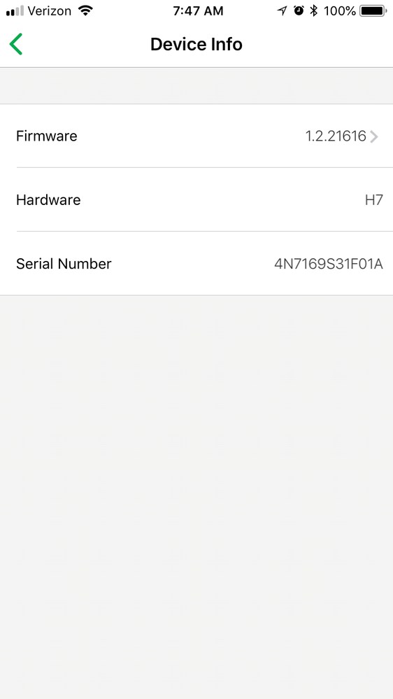

Here is another screenshot of device status
EaglesNest
