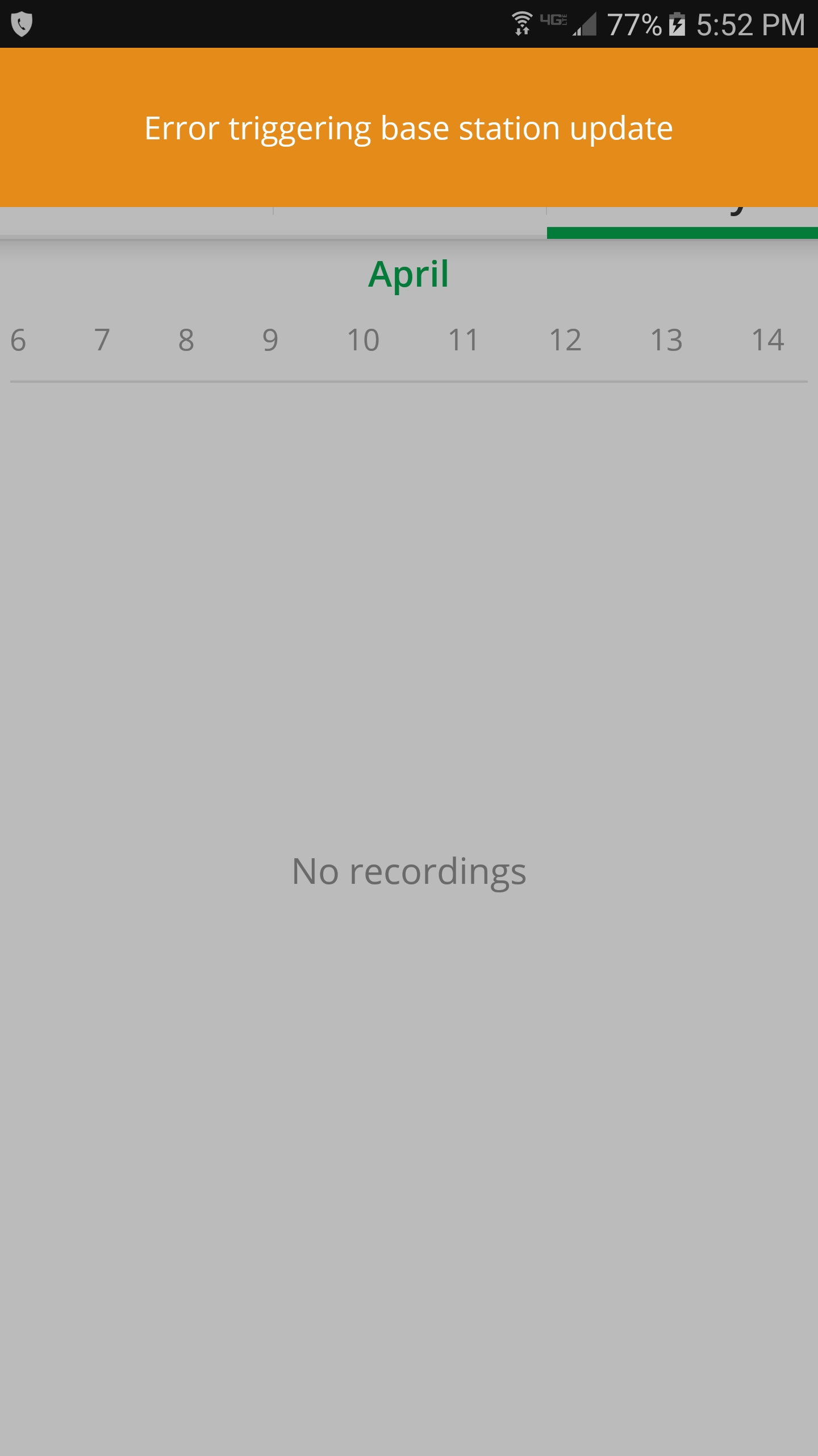

i just updated the Arlo app today only to find a brand new popup that states "new firmware 1.2.2688 update is available for camera # 1". I click to update and then it looks like its updating but 10 seconds later an orange band at the top of the app says "Error triggering base station update". I tried this 5 times - same thing. I also tried unconnecting and re-connecting the base station and tried multuple times again = fail...

If possible, could one (or both) of you post a screenshot of the error you are receiving, if you are still receiving it of course.
Thank you,
http://i718.photobucket.com/albums/ww181/csfirearms/Screenshot_20160414-175215_zpskokvmkjz.png

Yes the very same mesage as the picture uploaded, same thing exactly and my hub FW is 1.7.3_5005 too.
