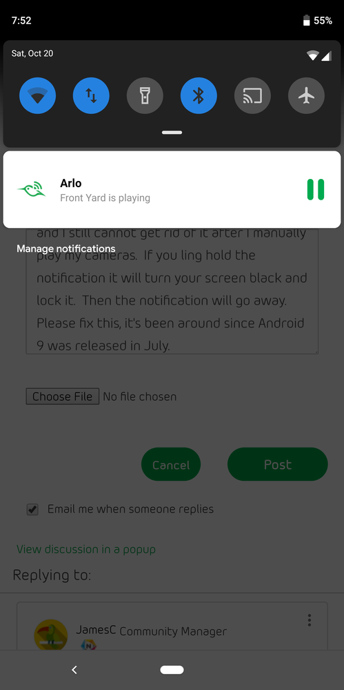

The notification says "Front Door is playing" with a paused indicator. It cannot be wiped away. If I swipe right and hold a setting "gear" indicator is shown. Selecting that clears the notification without showing any settings. Anything else and it stays in place. The pause button seems non-functional. Also this seems to happen randomly even when there have been no camera events.

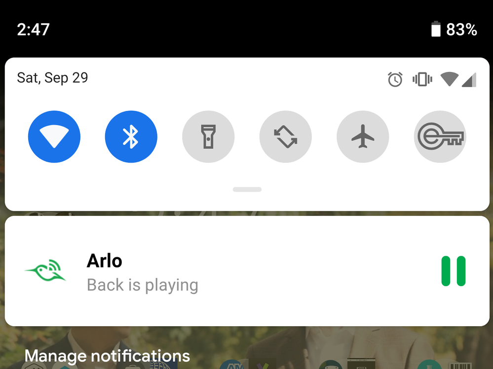

I'm not sure what trouble shooting steps you're referring to, as I didn't see any in the thread. I've attached the screen shot of the notification that cannot be swiped away, and tapping on the notification does nothing. (It doesn't open the app, it doesn't pause anything. It just stays there until the phone is reset. Forcing the Arlo app to quit does not remove the notification.)

I have two cameras, "front" and "back." They appear in my arlo app in that order. If I play the live view of the "back" camera, and press the "home" button my phone without first pausing the camera, I get the notification.

After the Android Pie update I get the same issue and it is reproduceable everytime. This is what happens
you are viewing your cameras live, if you do anything other than click "pause" (for example press the home or back button) you will get a notification that says "xxxx camera is playing"
there is a pause button next to it
The pause does nothing
if i try to dismiss the app it wont, but it slides to the left slightly revealing more options
a gear (for i assume settings)
and a clock (for delaying notifications)
if i click the gear the homescreen/launcher crashes (the background goes black) then the phone locks itself as if it has gone to sleep
the notification is cleared after this however
there seem to be no way to stop this particular notification as Arlo seems to only have the ability to turn on all or none notifications
I have provided screen shots

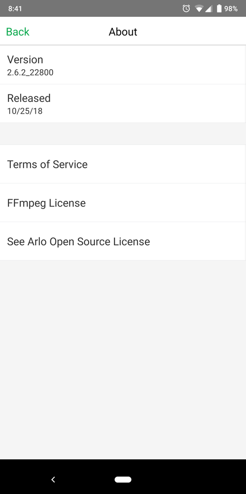

Recieved a new app update today at 1:55PM from the play store, v 2.6.1_22700. It appears this update still has not fixed the ongoing issue with the notification getting stuck on the screen and having to hold the notification the lock the screen and clear it.
Can we please get an update on to when this issue will be fixed and how has it been missed for 3 months?
