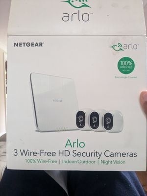

I purchased this brand new in 2018. I had tried to get it setup but was unsuccessful. I sent off a ticket in 2018 and was told to send it back. I've just moved house and decided to try it again but have seen that the company has changed since my original purchase. I've read all similar complaints and would really appreciate some assistance with this. Thank you!

The LEDs on the base indicate that the base hasn't been claimed into your account. What have you tried to do so? The base is connected to the servers as evidenced by the green Internet LED. You have to be on the same network (WiFi, not cell service) without a VPN to be able to claim the base.
You can also try to reset the base by holding a the reset button next to the power switch for >10 seconds, until the LEDs flash amber. Once the LEDs settle down to what you see now (green for power and Internet, amber for Camera, ~2 minutes) try claiming the base again.
