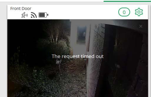

My Arlo cameras are very unreliable. I’ve tried taking the batteries out and resetting. I have to do this every day.  The battery strength is showing at 80%. When I get one camera working the next one goes down. Where do I need to send this back for a refund?

Leatherneck,
It sounds like the cameras are struggling to maintain a connection with the base station. This could be due to interference or range. How far from the base station are the cameras?
You could try relocating the base station closer to the cameras, to further isolate the issue.
