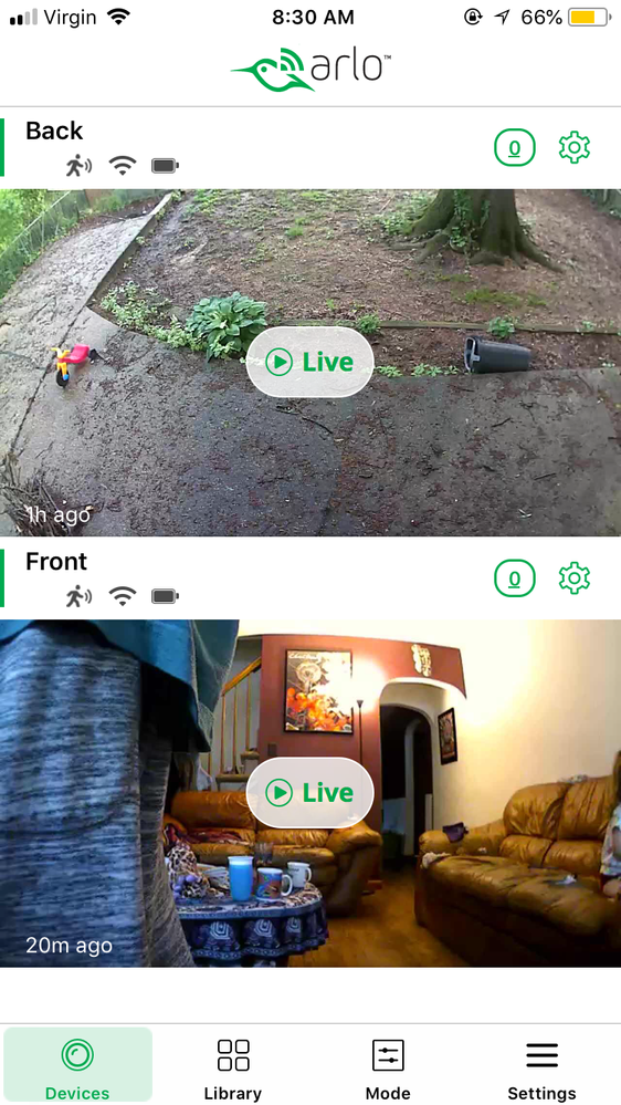

Every time the apps update my cameras seem to need to be reset
Now I can see them I can do live view but they won’t turn on and record for motion. I’ve re synced them, powered down base, and live view,changed batteries and walked around with them. Neither camera activate with motion. But both do live view. They are set for 100% sensitivity.
This usually always happens after app update and I usually go reset back to both my cameras and I’m good not this time
37 REPLIES 37
Are the running men for each camera gray or black? Gray means they're disarmed. Check your modes to verify that the proper one is selected.

I posted a picture they are exactly how they are supposed to bejeweled it is again. They aren’t registering motion to record but they pass the motion test through the app
damnyourupdates
You're not the only one. I am having the exact same issue as of Monday the 14th. Rebooted everything, motion is on all cameras, everything is connected, motion works when tested through app.
