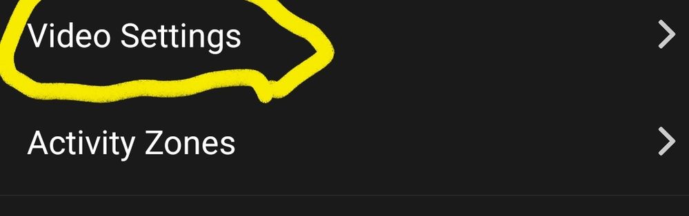

I have a brand new 3030 camera that I received from Arlo direct. Camera keeps recording and sending alerts outside of recording area as defined in video settings. This shouldn't happen but it keeps happening. I'm ready to scream. How do I fix this? No, I'm not talking about activity zones. I'm talking recording area in video settings for that camera. Thanks

It's direct from Arlo. They still have them due to the pink tint issue. Activity zones are not the same as the square you draw in video settings. If you look at your camera settings you will see video settings where you pinch to select the recording area. This is what I am talking about. Not activity zones.

That's the thing... the camera shows the active area selected in the recording box in video settings and during live stream but it still picks up things that were previously anywhere in the field of view. It doesn't make sense. The recording area is saved. Only that area shows but still it records anything within the sensors range or field of view even though the object doesn't appear in the feed or recording.
I have it in my driveway. I selected the area that is my driveway. Even though that is the selected recording area it still records any car that was previously in the field of view instead of what's actually in the video box.

No. It's being triggered by cars that are going by that aren't in the live feed or recording. But they are within the 130 degree angle of view if I left the pinch to zoom at default.

Again, it is not an activity zone. I have the activity zone setup but that just suppresses the alert outside the zone. It is the video settings. They are two distinct settings. It makes no sense that this one camera only records things out of frame where the others do not.
I shouldn't have to move the camera when I've had one in the same spot with the same view for years and never had the issue. That's the point of the video settings.
I stress that it is not an activity zone. It's pinch to zoom under video settings.
Things I can't see in the feed shouldn't be triggering the video. That's half the point of the video settings. I'm not new to this. I have a boat load of these cameras. I've had them since they first came out.
