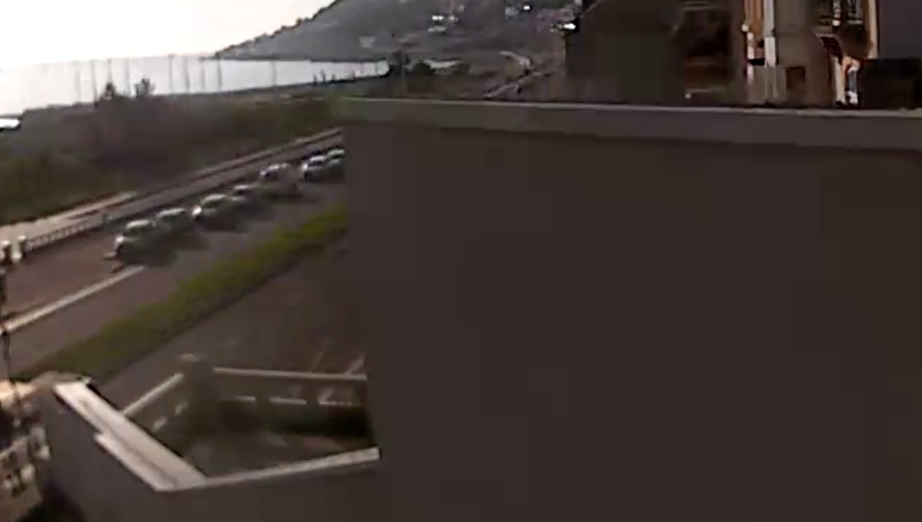

Here are 2 screen snaps, 1 at 00:00 (the cause of the motion dectection), the 2nd at 00:01.

I think the initial "flash" is just caused by the camera adjusting to the brightness level which appears to be rather bright. Nothing you can do.
The scene is too much. The water and street scene are likely what's causing the frequent recordings of nothing, especially the sun's IR reflecting off the water (and possibly windshields). Only view the actual scene of interest with the camera.
The image is just where i managed to aim the camera too. normally it's aimed only at grass, nothing else, but still get the flash.
It could be a slightly defective camera where the exposure control isn't working quite right but doesn't appear to be much of an issue - to me, maybe it is for you. If you have a second camera, swap positions to see if the problem follows the camera. To get it replaced you'd need to create a trouble ticket and work with support for an RMA.
