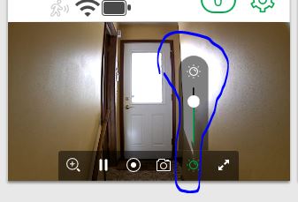

I recently found the brightness control after clicking on the "Live" button from the "devices" tab.
I have a dark hallway and it really helped.
Maybe they should place the brilliance control in the mode section as well, so that it can work with the other elements that control the image and response.

Jdhdjdhd wrote:
Thanks for showing me the location of the Brilliance control. Lets hope that helps my situation otherwise these units are pointless.
Thanks again.

jguerdat wrote:
The brightness control only varies the display and has no effect on the motion detection. If your scene is similar to that posted above, maybe rotating the camera down so the window in the door doesn't cause false triggers.
Sorry that doesn't and hasn't helped any, restarting, pulling batteries out etc. haven't made any difference either. Like I said, thankfully it only triggers few (wasted) recordings per day, it could be worse and from what I read from other users, it is a lot worse for many.
