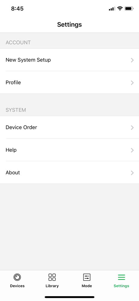

This implies that you never had the system set up before - is that correct? Have you held the reset button until the LEDs flash amber? What are the LEDs showing? How do you know the base need a firmware update if it's not even claimed yet?
Upon attempting to “Set up New system” I cant get passed the firmware update.
