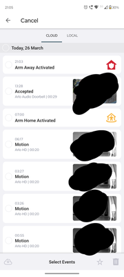

I’m experiencing random Automation Delays with the new app (version 5.5.0.)
For example; I have an automation to change mode from “Arm Away” to “Arm Home” set for 8AM every day. When I look at the “Feed” the mode actually changes at times of 8:06, 8:07, 8:15, etc. It never actually changes at 8AM. This appears to have started occurring with the "new" app. Any suggestions?

Glad it's better for you but that's not the case here. The daytime schedule change is usually at 6:00AM (but not always) and the nighttime change is usually at 11:03PM instead of 11:00PM.

Not fixed for me either. 7:03am this morning and yesterday instead of 7:00am.

21:01
Still not 21:00 as it's supposed to be. And it's now nearly Wednesday, even though we were told that this would be resolved by Monday.
