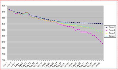

BTW, back in the day , Jeff and I tested many brands of rechargeable 123s....
out of all of them, the nitecore was prob the most true, consistent one.
As a side note, most RECHARGEABLE batts will be rated at about 650 to 750mahr, you physically can NOT fit more chems in the battery for more ( so if you see one rated for 1500mahr or 2000, it BS )

As mentioned, Tenergy 3.7v li-ion are the only approved rechargables for the added safety features in the charger and cells....
Many 3.7v li-ion were tested in the past , some better than others, some junk ( esp from china ).... all will work but verify that they do have protections for over charge / over drain with a suitable charger. One or two brands were possibly a fire harzard.
If you do a good search, some of the findings are still listed.
Just a few hints if you choose rechargeables;
Tenergy are the only Netgear approved ( they work well )
No 123 rechargeable cell withh support more than about 700mahr ( cant phyically fit enough chems in that package )
Most ebay cells are junk
MOST IMPORTANT; that cells have a PCB to prevent over drain/ over charge
LiFepo4 123 cells tended NOT to work well in Arlo
Do not use 3.2v li-ion but use the 3.7v li-ion cells
