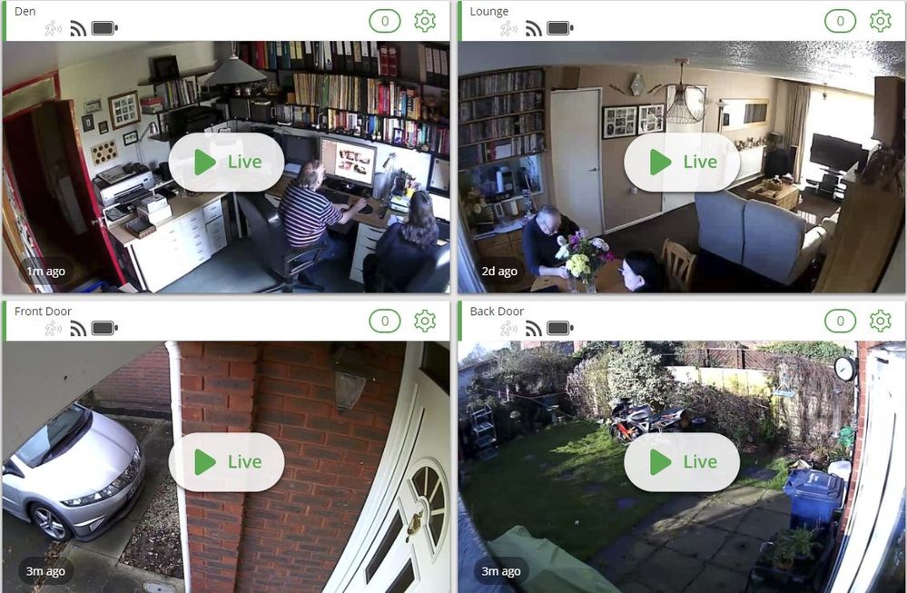

Hi, I have recently installed a 4 camera setup with the base station next to the router in my office in the upstairs front room. The cameras on the ground floor, particularly the one outside the back door, have a much reduced signal. If I add a second base station downstairs, connected via a powerline to the router, I assume this is OK and the downstairs cameras will get an improved signal. Will this be OK with my basic (free) subscription. Will I be able to add a 5th camera to that subscription with 2 base stations?
Many thanks

Thanks again. Your reply prompted me to try putting the base station in the lounge which is equidistant from all 4 cameras. I plugged it into a spare port on a router that has the modem disabled and that acts as an access point to the WiFi. All works fine and I now have full bars on the signal strength for all 4 cameras. You have saved me £90. Thanks again.
