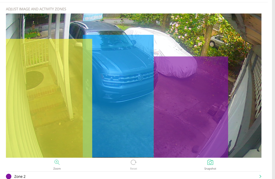

Video doorbell activity zones not working
I’ve literally lost track of the number of times my doorbell sent a trigger notification today.
Kirk
This is getting really frustrating.
I had 129! recordings outside of the notification zones yesterday between the hours of 1:22 am and 11:17 pm. A few made it through as notifications even though I have selected notification only for movement of persons.
This is the definition of broken in my book.
I'm just adding my two cents. Activity zone is set to exclude the passing cars and it triggers constantly. There's construction across the street so this is sometimes hundreds of triggers per day. The triggers all say motion and it's almost always a passing vehicle. I have shrunk the zone and lowered sensitivity. This is very frustrating.
I'm still convinced that a firmware programmer, probably on a contract, since most technology firms don't believe technical expertise has any value these days, enabled the microphone for triggering video events. However, the system programmer upstream who was supposed to handle those events at the server level, got his project cut short by a manager wanting a promotion, who cut all of the project development time estimates in half to make his numbers look good. So, all of us users have a system that doesn't work because evidently, no one still at the company has any idea how it all works.
I think I'm going to put some chewing gum over the microphone hole and thank Richard Dean Anderson for the suggestion.

The activity zones in my own doorbell are set that way - covering just the porch. But they aren't being properly applied. I got over 650 recordings yesterday with the default motion sensitivity of 80. About 5 of them were in the activity zone.
One complication is that there is also more video corruption than there should be - which will generate false results with the cloud activity zones (since the corruption shows up throughout the picture, including inside the zone).

When you say that the activity zones just cover the porch, do they cover the porch area, but with a background past the porch? That is what I am trying to establish for Arlo. I have my activity areas only set on a wall and the floor of my porch, no other place where motion could be incorrectly interpreted.
They cover just a bit of the approach (e.g., the front steps). But not anywhere close to the road or town sidewalk. No sky, etc.
I have done a test where I placed a chair a couple feet in front of the doorbell, and set the activity zone to only cover the back of the chair. So there be no possibility of motion. That did not supress the motion recordings.
