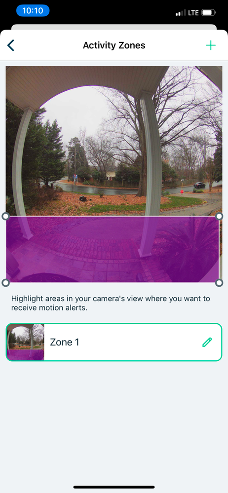

Elboydo,
Can you provide a screenshot of your zones screen so we can get a better understand of your camera facing?
Hi,
for some reason i couldnt upload directly from my iphone, but here are some screen grabs
and another screen shot

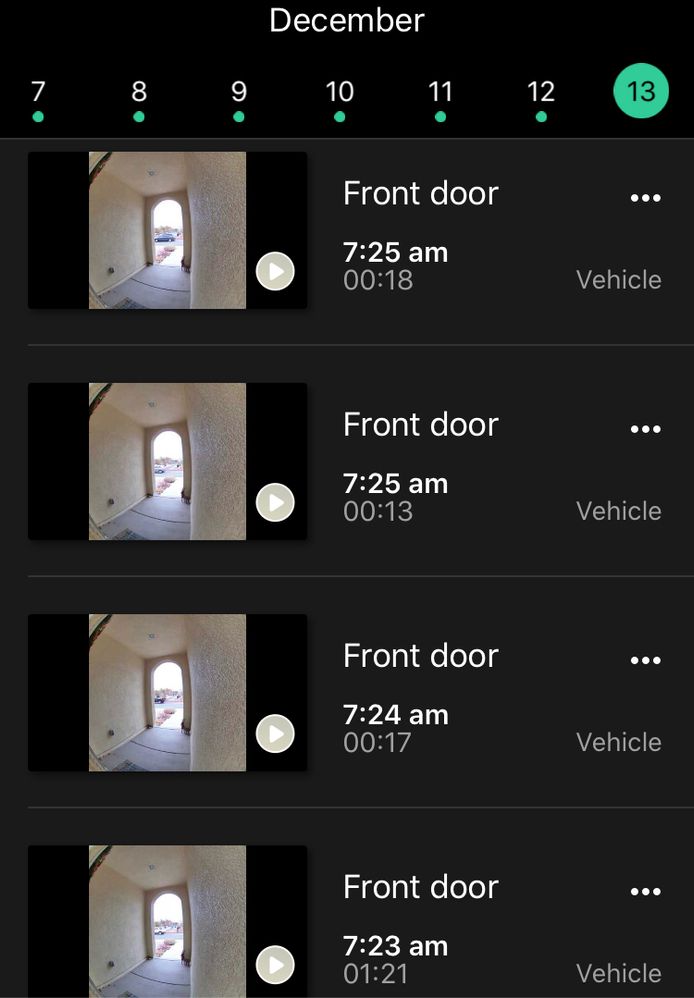

Elboydo,
Are you able to share a video clip that shows a trigger that should not have occurred?
The forum will only let me upload files with the following .jpg, .gif, png pdf, extensions. Is there a trick for uploading a .mov file? can I email it to you?

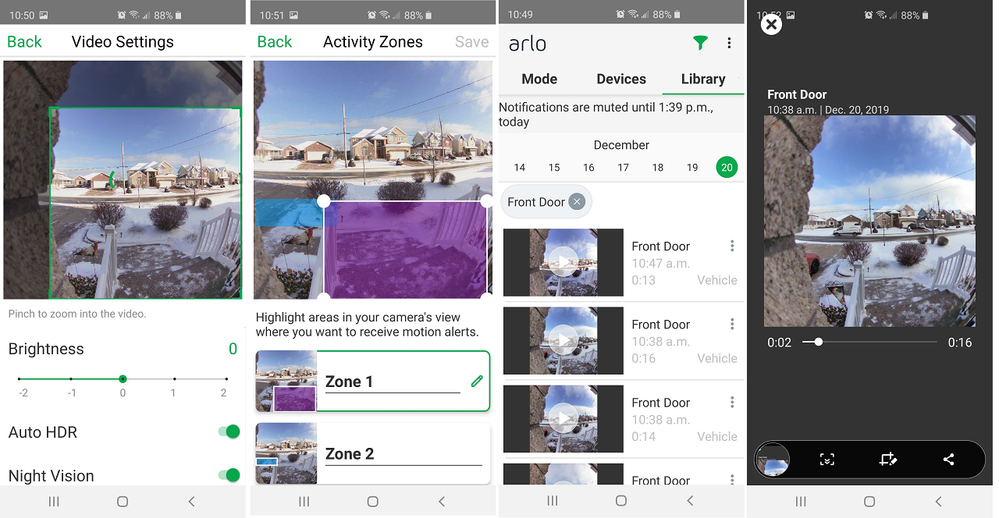

I have the same issue with the Doorbell ignoring the activity zones.
The activity zones seem to worked intermittently. Some days, they appear to work correctly, other days they record and send notifications for everything.
I also noticed that the zones do not appear to be tied to one's zoom settings. The recordings are to the full screen even though the zones setting interface uses the zoomed image for setting zones.
I have attached screenshots of the various settings to show what is occuring.

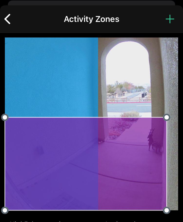

I am having the same issue with activity zones and motion warnings triggered outside the zone. I’ve been shrinking the zone over the last day to no avail. See attached screenshot.

I have gotten over a dozen false warnings outside the activity zone today.
A couple of things.
1. If you set the sensitivity via setting/device utilities/motion detector test you are only changing the sensitivity during the test. To change the true sensitivity of the camera, it need to be changed via the modes function. As my doorbell camera is always on its modes/doorbell/edit mode/rules. i have had better success with this
2. the other item that helps is that my original activities zones were set after the camera had been zoomed. I went back and zoomed out to the default setting and then re-set the activity zones. While this didn't solve the issue, it certainly cut down on the number of nuisance notifications.
