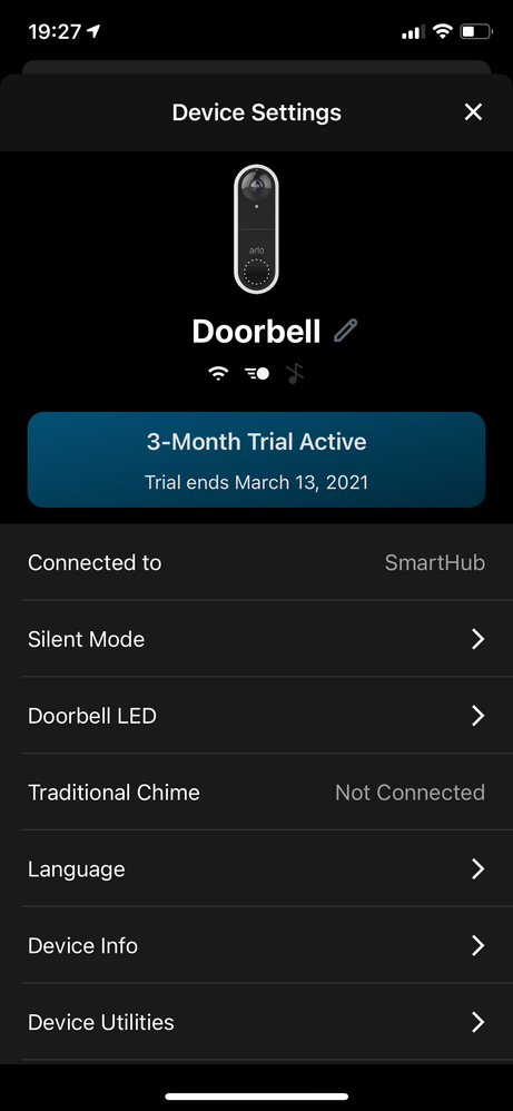

Where it says “Traditional Chime”, I am unable to tap/click anything on that line. It just says “Not Connected”.

You should be able to tap the dropdown button next to "None" and change to Mechanical or Digital. Could you provide a screenshot of what you're seeing?
Thanks for getting back to me. I attempted the attach a screenshot last time but the website didn’t like the image from IOS
Attempting it again now. (Seems to have worked this time!)
Note: it says “Not Connected”
not “none” as I originally explained. Oops 🙂
Mark
