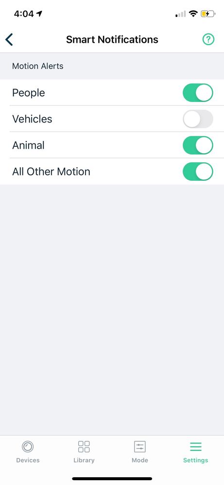

I recently purchased this and am having the same issue.
I have set my activity zone to eliminate the road and I've turned off the vehicle in Smart Notifications.
I get notifications every few minutes for the cars driving past. How do I turn this off?Activity Zone
Smart Notifications
Sensitivity setting
I have the same issue -- turned off vehicle notifications in the app, but it keeps notifying me anyway.
My setup is very similar to yours. You are setting the sensitivity in the wrong place. You need to go to MODE and set the sensitivity within the mode you are using, not sensitivity test. I reduced mine to 17% and now only get large trucks and big white SUVs.
