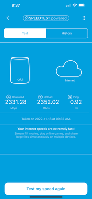

My download speed is in the file image.

It's clear that your issue is not related to your internet connection speed, but there could still be some wifi interference or signal issue with the base's closed wifi. If you have a subscription, you could also try shifting the doorbell to your home wifi network (though that is a pain, so I fully understand if you don't want to do that).
