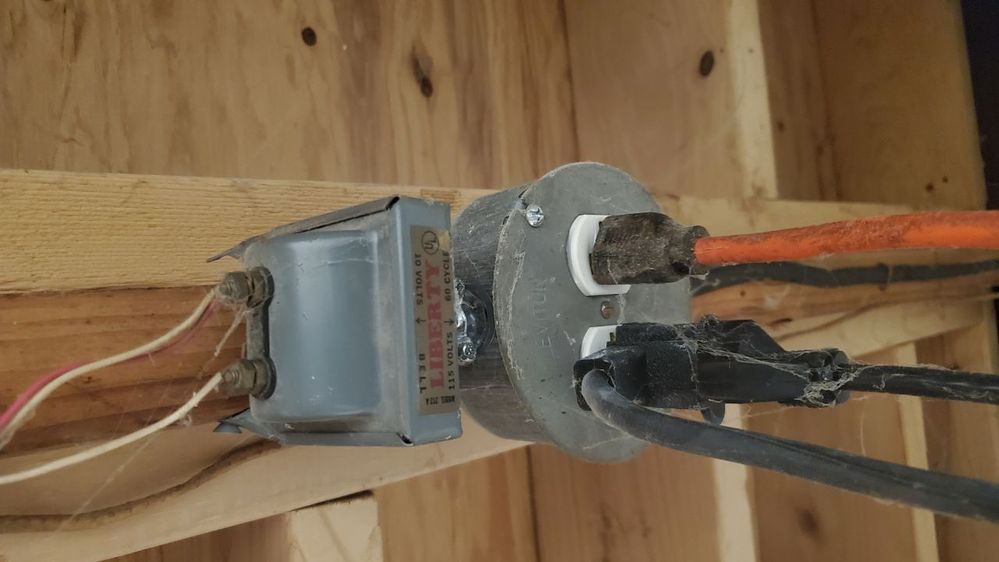

Attached is my transformer which should be compatible and ill post my chime in a minute

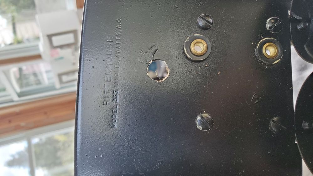

Heres my chime. I think it says 10 volts. Im not sure if thats a problem or does just the transformer have to be between 16 and 24v
I might have answered my own question. The transformer says 10 volts as well.
So im correct and the transformer needs to be replaced. Does the chime also need replacing?
Hard to say - I'm not seeing a manual or specs on line.
You could also look into exchanging the AVD1001 for an AVD2001 (which is spec's down to 8 volts).
But I think the AVD2001 uses the same power kit - so if the original doorbell won't ring with the power kit installed, then I think you'll still have a compatibility issue.
