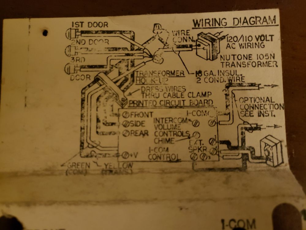

I am trying understand how to install the power kit on my doorbell chime. My chime does not match the one simple example that Arlo provides support for, but it is not some esoteric product. It is a Nutone product that is recessed into the wall that supports 3 doors. I am installing only one doorbell at this time. There is no labeled Trans terminal on the board. I attached a picture below. I believe that there is likely a wire that I need to connect to, but not sure how to identify it. Anyone else run into this situation?

I then decided to call the manufacturer of my 25 year old door chime, Nutone. They were extremely helpful. They provided me a wiring diagram for my LA174 chime. They still make this product today. I haven't gone back to the installation, but now I am hopeful.

Yes I have it working. I called Nutone. They were great. They sent me a wiring diagram for my model.  (LA174) I wired one wIre of the Arlo power kit to the door terminal. The other wire needs to be connected to the Yellow wire which is the transformer wire. That requires you simple cut off the end terminal on the power kit, strip the wire and connect in to the yellow wire bundle. In my case there was the yellow wire and one other white wire. Works perfectly.2020-01-11_171031.jpg

I looked high and low for decent instructions, this explanation with the wiring diagram really helped. My model is actually a Nutone C39854, but the diagram behind the chime is basically the same as shown above.

As far as I can tell, the arlo power module is just a resistor. Nest has a 4 wire adapter, that sends power to the doorbell, and then acts as a relay to just send an open / close signal to the chime input, which seems much cleaner, simpler, and a lot more reliable. I would love to see Arlo copying that design. It seems like that could be done without a full redesign of the doorbell either, just would need a different adapter module.

Thanks, would love to see a diagram of what is going on when this is hooked up. Still struggling to figure out how the result of all my setup can be a double ring (with a little time in between, it isn't immediately back to back). A diode would make some sense, but it would have to be more than one or the directionality would matter. Maybe a diode bridge.
@dougp1122 it is my front door, but I thought about swapping the two to reduce the overall amount of sound produced. Sounds like that is the way your system is already, I will probably have to try it.
The diagram in the back of my chime was actually legible enough to accurate that combined with your instructions and diagram I don't need anything more. Except something from Arlo to explain what the power module is doing and how it is doing it.
