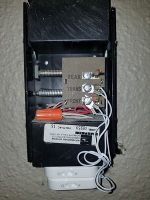

Just installed my 2nd ARLO VIDEO DOORBELL (AVD) and hooked up the TRADITIONAL CHIME which is not working. I have restarted the video door bell, and turned the 24vAC power off and on to the chime (stated as a solution in another post). The traditional chime is not working with the 2nd AVD. Since this is the 2nd arlo video bell on the hub, has anyone wired two doorbells to one traditional chime? The switch is set to "0", for both power units and the other video doorbell, does ring the chime as it is supposed to. Everything else works on the 2nd AVD as it should. Is there a way to check the 2nd power unit?
Both power modules are installed between the front doorbell connector and the transformer connection..
That isn't right - the rear door power module should be connected to the rear and the transformer.

Right now you have both power modules connected to "front" and "transformer". You don't want that, so remove one of those power modules.
