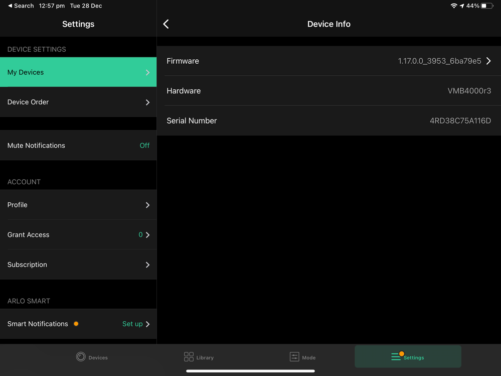

Ok so just bought the wire free door bell. Currently trying to set it up. I open the app, “add new device”, then follow the prompts. I’ve entered the SSID EXACTLY. I enter the password exactly as well. The camera picks up the the QR code no bother according to its audio feedback. I press continue on the app and sit both the phone & doorbell in front of the WiFi hub. The apps searches and the doorbell flashes white. Sometimes the doorbell eventually flashes amber a few times then stops flashing all together. Sometimes the app says it can find the device. WiFi hub according to my phone is 2.4GHz.
been through this process multiple times. Even tried to scan the WiFi QR code in place of the one the app gives. That makes the the doorbell instantly start flashing amber then stop. Base station is a VMB4000r3. Apparently it’s got no more updates.
Please tell me it something stupid I’m doing wrong. Was really excited to add this to the rest of the arlo system which has been amazing so far.

StephenB
@Urbexwolf wrote:
So just to confirm I should now be able to connect my wireless doorbell straight to the smart hub instead of relying on the WiFi?
Yes.

StephenB
@Urbexwolf wrote:
Can you confirm this is the update? I’ve asked it to update and it say there are no further updates available.
Firmware releases are posted in the forum here:  https://community.arlo.com/t5/Firmware-Release-Notes/bd-p/arlo-release-notes
The VMD4000 firmware post is here: https://community.arlo.com/t5/Firmware-Release-Notes/Arlo-Base-Station-VMB4000-1-17-0-0-3953-6ba79e5...
You'll likely also need to update the AVD2001 - onboarding it to wifi first, updating the firmware, and then moving it to the base.
Urbexwolf
Brilliant thanks. When the doorbell is updated via WiFi. Do I reset the doorbell before trying to pair it to the base? Do I try to simply find the doorbell through the base like when pairing a camera?
kind regards
Just remove the doorbell from your account and set it up fresh. As long as everything is up to date (doorbell, base/hub and app) you will be able to choose.

Thanks for this, this is the furthest I've got in a while. I've updated the bell via WIFI. I have got past the bit where it checks if the base needs any updates. It's now looking for bell. However when I press the button to start pairing it does about 5 fast flashes then starts to flash very slowly. Sometimes it stops for a few seconds all together. Is this correct? I'm going to leave it on charge tonight incase that's the issue.

Urbexwolf
Good morning. WA the same after I'd given it a charge. So I tried a hard reset and started again. Connected first time.
