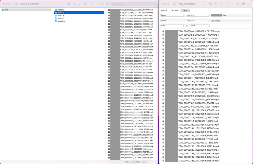

Has anyone ever tried accessing the microSD card from a computer? There doesn't seem to be any rhyme or reason why the "Smart"Hub organizes the way it does.
Today, I had to pull videos off of the microSD card using my Mac because I, too, cannot access local storage through the Arlo app.
To find the videos, I had to search by the device's serial number, the date with the format of YYYYMMDD, and the file type. Because the "Smart"Hub inserts a random string of characters mid-file name, I had to sort by Date Created to arrange the results in chronological order.
I don't understand why a computer's search function is the only serious way of retrieving videos of off the microSD card.
I've seen this complaint many times. In addition to the fix to allow access to local storage through the app, maybe we can also get a new logical folder structuring and file naming scheme?
To be fair, the local storage is advertised as a backup, not a primary method of storage. Not sure why computers aren't allowed to view the local storage directly - maybe a future enhancement (or not)? Use of the app removes all the naming issues you see on the computer.
