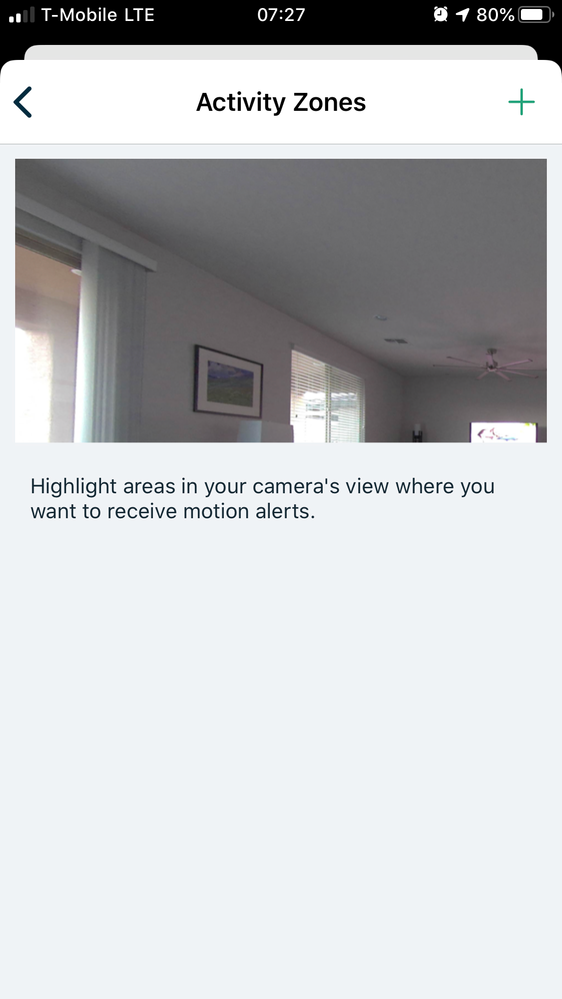

Not able to set activity zone, only upper left of field of view is shown. Tried to change camera field of view, flipped 180° and back, tried all video adjustments and still same thing. Also on this camera the audio icon is grayed out but it works flawlessly.
I have this same problem and, while reading this, had an idea that seems to point to the problem. I just repeated this test with two different cameras and it produced my expected results:
Activity zones shows upper left corner.
Change camera to NOT 4k
Activity zone is correct.
Change camera back to 4k.
Activity zone is upper left only again.
So from what I can tell we need to set the zone while NOT in 4k mode. Not sure if it works correctly, once set back to 4k.
